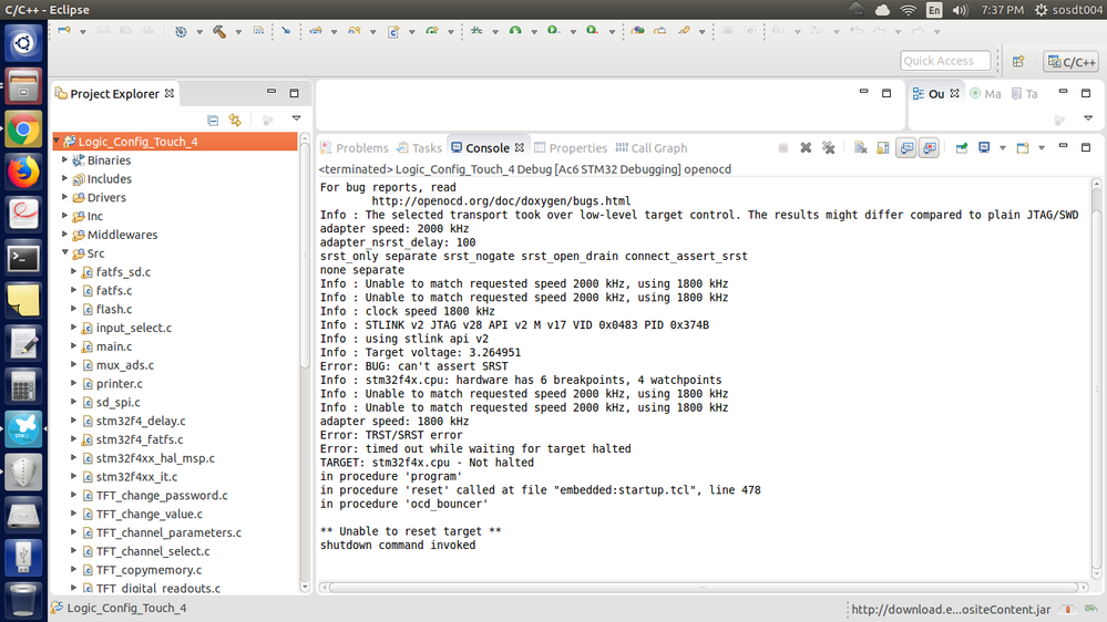

We are using ST32F405ZG and ST-Nucleo with a custom board design with SD card interface provision in it.
We are getting an error message as shown in the snap shot attached. Please provide some help in this issue.

Would seem like you've balls up something in the design or connectivity...
No design details provided. It's a custom board so no one here was involved or familiar with the design.
Make sure the Nucleo on-board target is disconnected.
Check usual issues/suspect, covered here dozens of times,
Voltages on VDD, AVDD
Voltages on VCAP pins
Voltage on NRST pin
Accessibility of System Loader when BOOT0=High and connected to USART1 PA9/PA10
Those messages are your Eclipse IDE debugger failing to connect via the ST-Link - this has nothing to do with the SD Card interfacing!

Thank you for the reply.
I have gone through the code examples and found that the line below was missing in my code under the file 'Logic_Config_Touch_4.cfg' :
reset_config srst_only srst_nogate
This made the program to build and upload the program to the controller.
But now the issue is SD card is not getting mounted using FATFS thirdparty library.
The program executes and skips out of the mount function stating FR_INVALID_DRIVE
now I got got stuckup at this point. Don't know what to do next...
