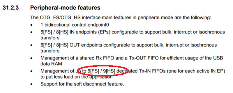

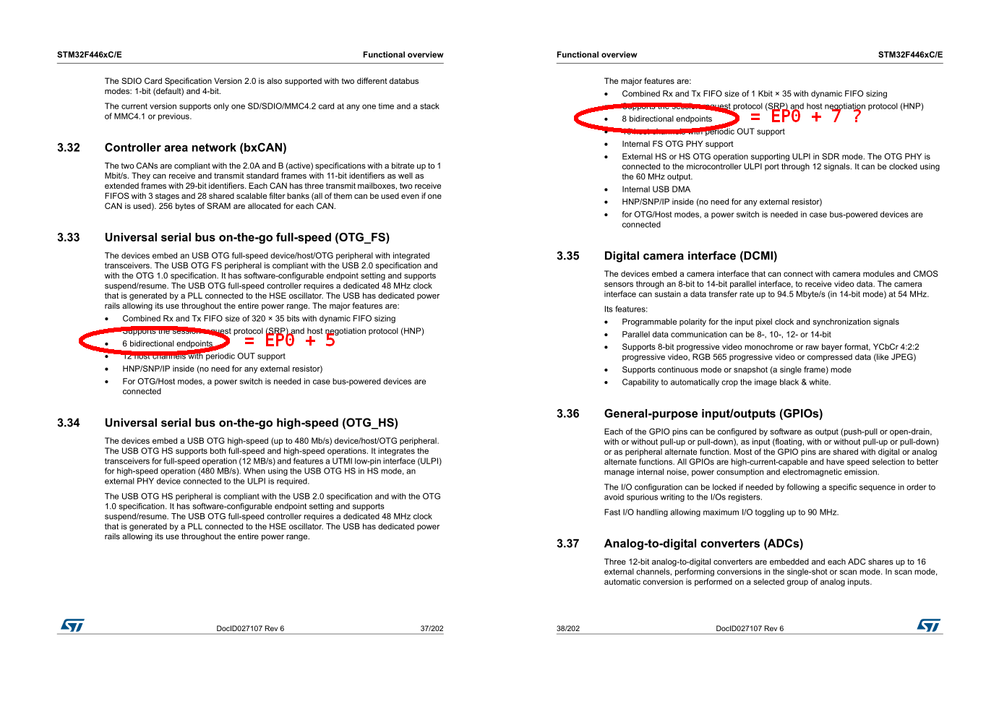

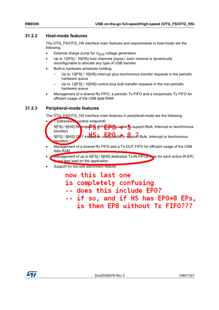

Hello Jan,
Number of endpoints: 6[FS] / 9[HS]
-> 5[FS] / 8[HS] device endpoints + 1 bidirectional control endpoint0This was fixed on
and already highlighted to be fixed on the datasheet.Thanks for your feedback.
Khouloud.

Hi Khouloud,
In [STM32Cube_FW_F4_V1.21.0]\Drivers\CMSIS\Device\ST\STM32F4xx\Include\stm32f446xx.h :
♯ define USB_OTG_FS_MAX_IN_ENDPOINTS , , , , , , , , , , , , , , , , , , , 5U , , , /* Including EP0 */
♯ define USB_OTG_FS_MAX_OUT_ENDPOINTS , , , , , , , , , , , , , , , , , , 5U , , , /* Including EP0 */,
♯ define USB_OTG_HS_MAX_IN_ENDPOINTS , , , , , , , , , , , , , , , , , , , 8U , , , /* Including EP0 */,
♯ define USB_OTG_HS_MAX_OUT_ENDPOINTS , , , , , , , , , , , , , , , , , , 8U , , , /* Including EP0 */is still wrong.
I'd say the same applies for HS in 'F469/'F479 (I've seen RM386 being fixed in this regard, I assume the related datasheets are flagged already).
Jan

Hi Jan,
This point is also internally reported and will be fixed soon.
