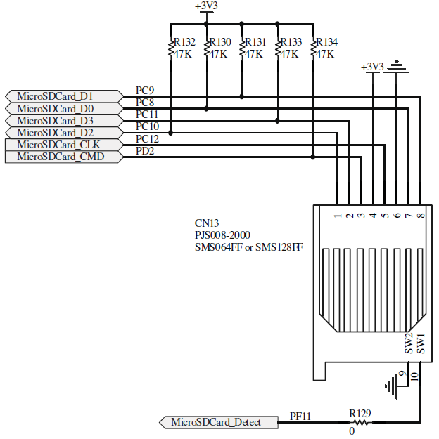

2017-09-27 1:41 PM
Hey
i finnaly got my sd breakout board.
I connected as shown in your picture, however it does not work somehow
I'm using 1bit bus width, therefore i'm only using D0, D1-D3 are not connected to the MCU but they are connected to 47k pull up resistors.
I generated a sample project with cube MX. I did not make any adjustments to the generated code yet.
At startup BSP_SD_Init() is getting called, and within that SD_PowerON().
As far as i can tell SD_PowerON() sends serveral cmds to the sd card.
1st: CMD0 go to idle
SDMMC_CmdGoIdleState() =>OK
2nd CMD8 SEND_IF_COND
SDMMC_CmdOperCond() =>Returns with SDMMC_ERROR_CMD_RSP_TIMEOUT
Do you guys have any ideas? Connection seams to be working if SDMMC_CmdGoIdleState() returns with OK right?
