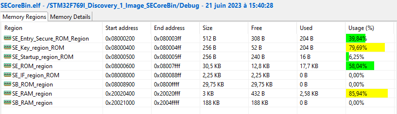

When I'm compiling the SECoreBin, my memory regions look like that :

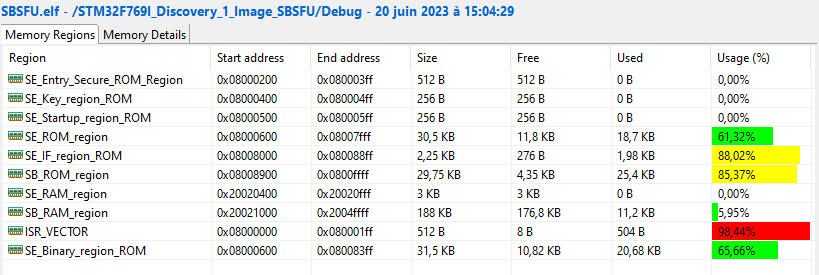

But after compiling the SBSFU, my memory regions look like that :

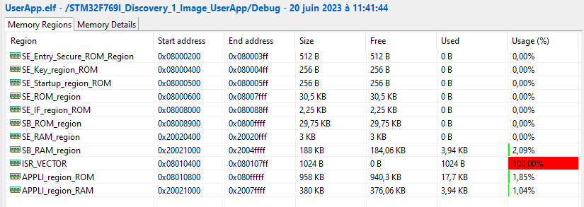

And after compiling the userApp, my memory region look like that :
After programming the SECoreBin, all the regions in the first screen are populated but after programming the userApp or the SBSFU, those regions are erased. So when i'm trying to jump in the SecureEngine, the code cannot execute the code at the entry address.

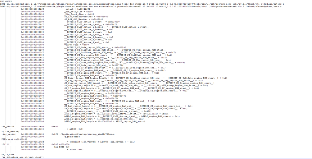

In the UserApp.map, we can see that the other regions are defined but not populated :
