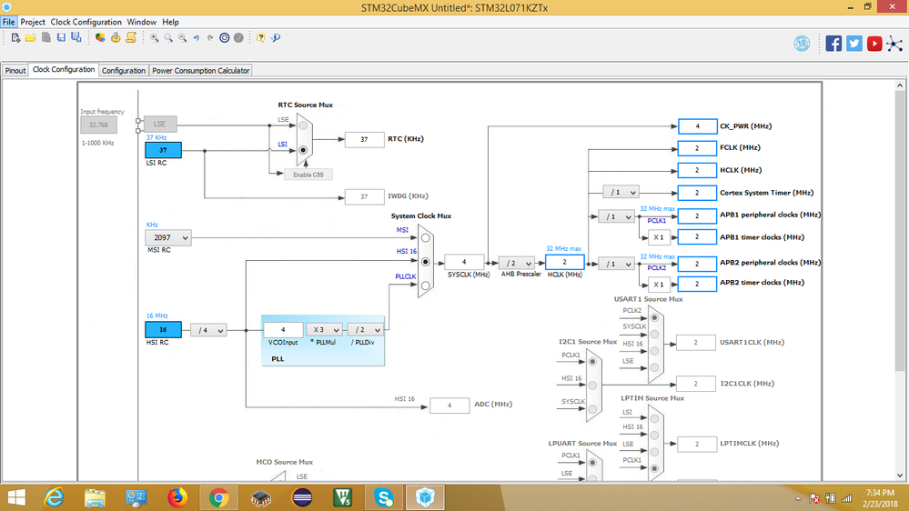

I have set internal clock frequency 1Hz but RTC time is faster than the real time
I have stm32l0 rtc clock LSI with 37khzPREDIV_A=125 andPREDIV_S =296

2018-02-23 7:08 AM
2018-02-23 7:09 AM
above image RTC Clock is 37khz
2018-02-23 11:30 AM
So, does that make the math work any better? 126*293 != 37000
