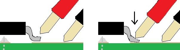

Even hardwired the 2 ''strange'' ADC channels refuse to give a coherent digital value.That was too much...i lifted components around then put the circuit under microscope...the track looks non cutted,and checking with ohmeter once more confirmed connection between ADC pins and opamp out.Checking better i discovered the error:Simply ,after one air removing and resoldering of a crystal close to the pins,the 2 pins of the interested channel remained sligthly llifted,so close to the track that the pressure of the multimeter probe tip was enough to reconnect it during measurement,due to the fact that the center of the uC was a bit lifted because of the thickness of ''handcrafted vias'' and some elastic force was presentThe lesson for me is that my home made SMD PCB are good for immediate test,but manipulate it again and again and they will show some of their weakness.
