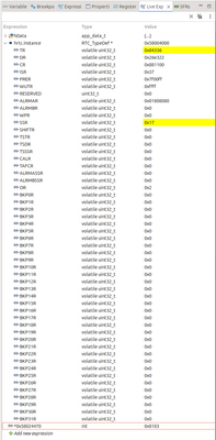

Can you print real time capture of all RTC registers ? I trust you set all correctly at start but someone could have been corrupted during operation.
Like this
Do not forget RCC_BDCR aka *0x58024470.
