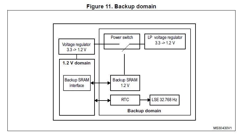

2018-09-16 8:34 AM
You're right, of course, the datasheet mentions only LSE ... This is annoying, but can be fixed easily.
Thanks!
2018-09-16 9:16 AM
You don't mention the STM32 model/family, but in most the low power domain doesn't include the LSI, usually a block diagram in the RM
