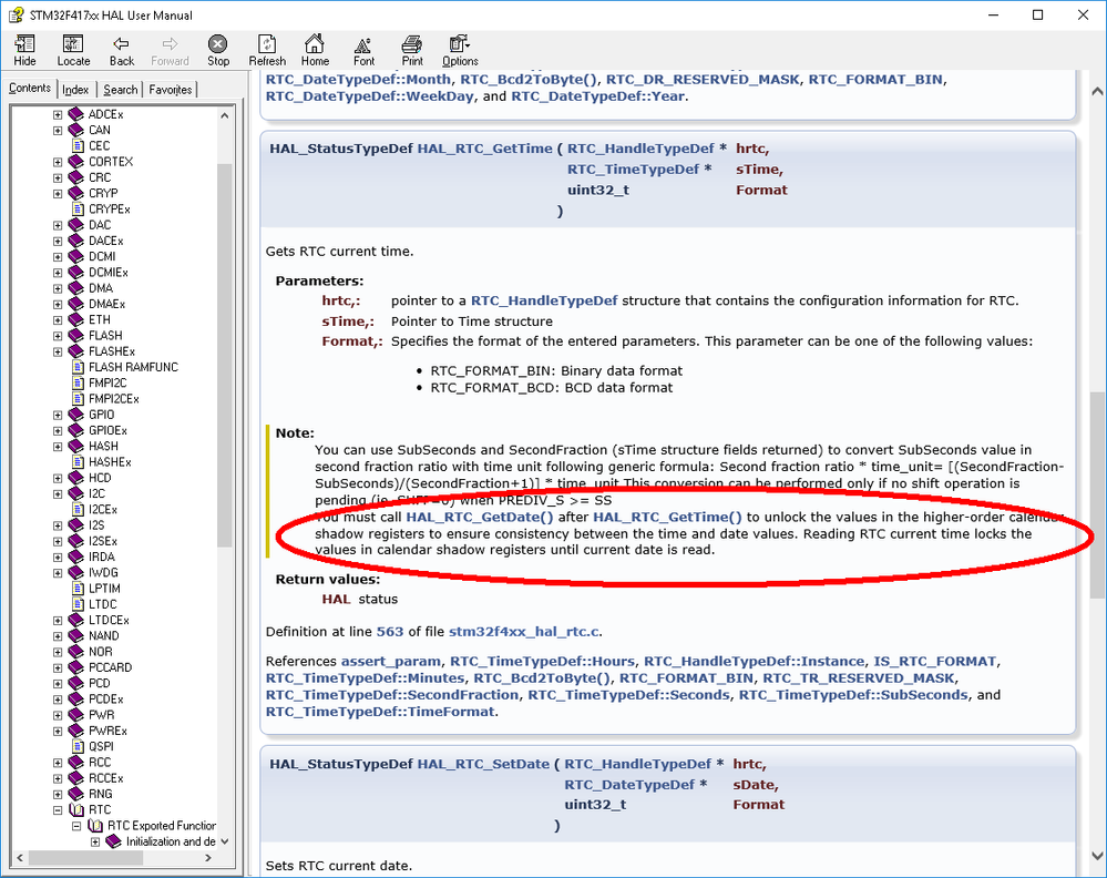

2017-07-02 7:27 PM
Hello
Waclawek.Jan
by the way, i want to ask you about this manual, from where did you get this format (*.hlp or *.cnt) ? (like in the screenshot)
all documents that i have are in pdf format!
thanks !!
Farouk
2017-07-05 4:52 PM
Farouk,
this screenshot is from [STM32Cube_FW_F4_V1.4.0]\Drivers\STM32F4xx_HAL_Driver\STM32F417xx_User_Manual.chm
Jan
