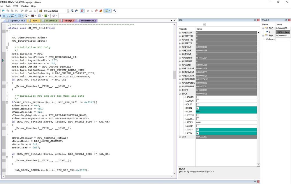

What's the content of RCC_BDCR?

RM0395 Reference manual, page 243, Backup domain control register (RCC_BDCR), Bits 4:3 LSEDRV[1:0] LSE oscillator drive capability.
It is necessary to increase the value of this register.The LSE generator can reduce the voltage swing on the quartz generator - to save energy and the life of the quartz itself. But at the same time, the contacts and the body of quartz become a good antenna, with a high sensitivity to interference. The case of quartz must have contact with the ground - this will reduce the level of interference.2017-08-29 6:21 AM

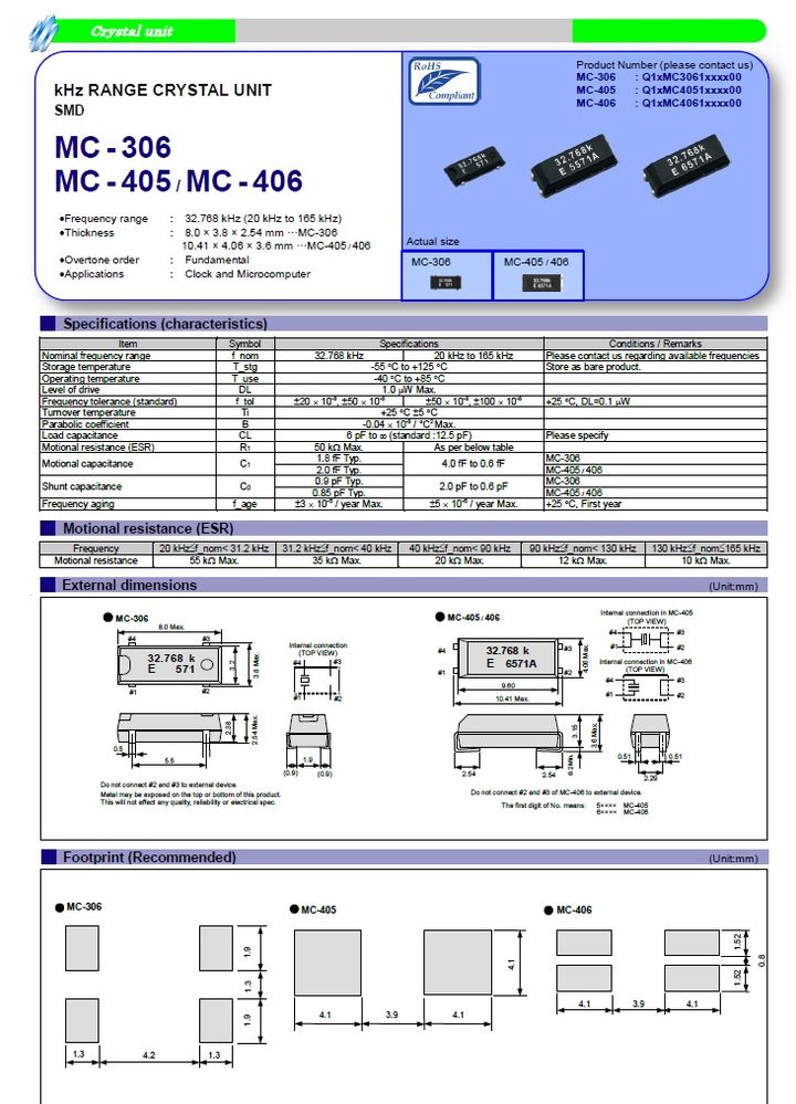

Pretty sure the L4 has different drive circuitry than the old F1. Most should deliver ppm accuracy if correctly implemented.
Do you have datasheets for the *specific* crystals that you purchased? ie fully qualified part#
Are these 6, 9 or 12pF crystals?

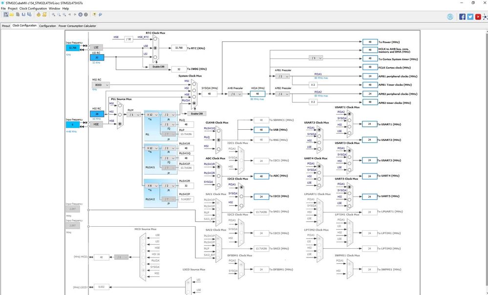

Here you have a screenshot (debugging session) showing this register as well as the initialization code and a second image where Cube clock configuration is also shown.

It is a 6pF crystal.
Please, find enclosed its datasheet.
Furthermore, I have already modified LSE Drive to 'Higher Driver Capability' and result is the same....

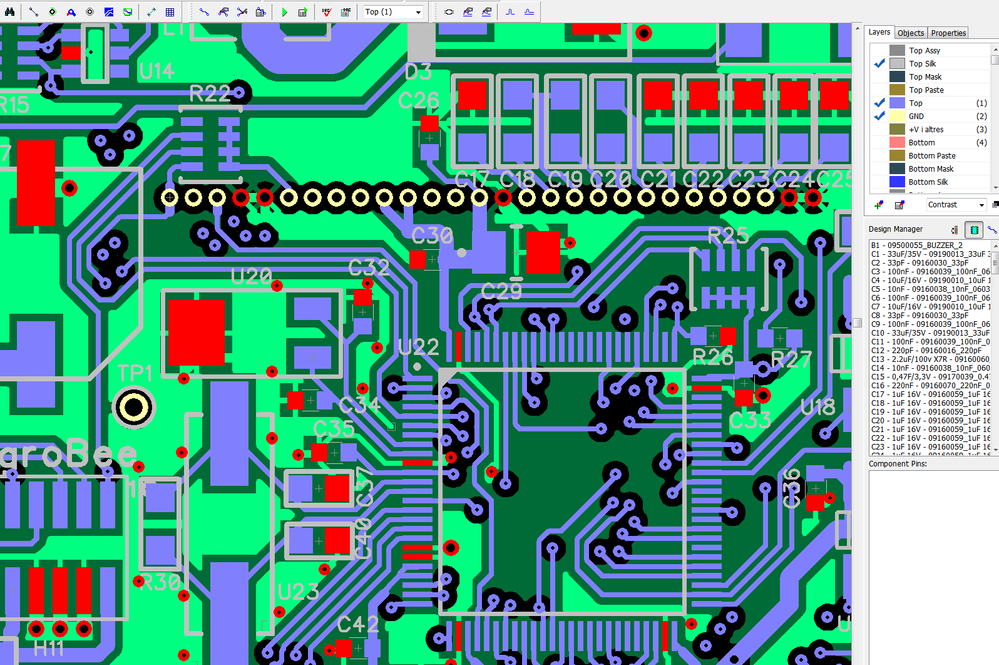

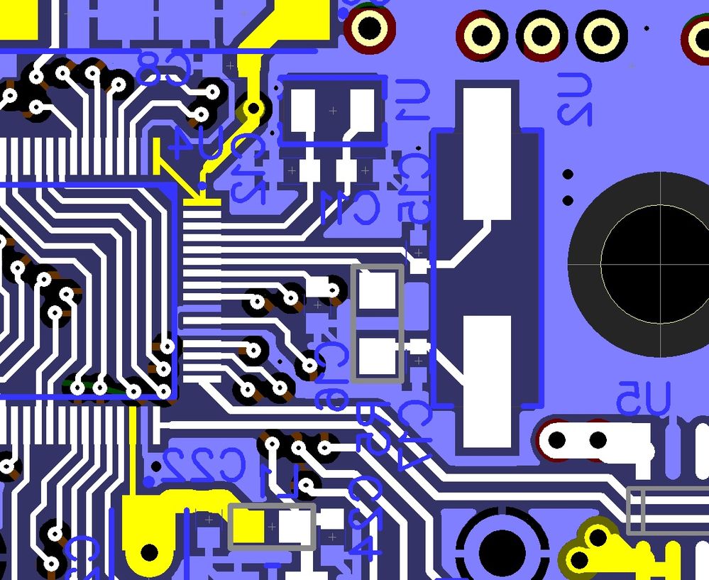

- We have just received a different pcb (based on same micro) and we have tested it: in this case, the read frequency at PA2 pin is correct. Being in this situation, we have also enabled PC13 for the 512Hz calibration output --> this makes the PA2 to be 32.5KHz and PC13 is about 508Hz. In the same situatiuon, if 512Hz output is mapped to PB2 (instead of PC13), then we get 32.1768KHz (PA2) and 512Hz (PB2). So, it seems that PC13 is coupled with crystal IN/OUT when it is enabled as a calibration ouput.
Apart of this, and in order to guess what it is happening with the first pcb, please find here below a screenshot of both pcbs: the one we have been talking about and the second one, where crystal is working fine. What is your opinion?
Best regards,
