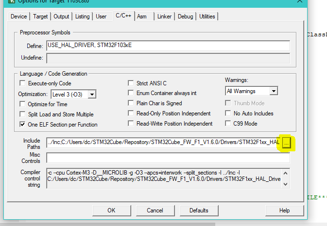

I installed STSW-STM32054
I think I need to change #1 to #2 but how ?
________________ Attachments : change.jpg : https://st--c.eu10.content.force.com/sfc/dist/version/download/?oid=00Db0000000YtG6&ids=0680X000006HyTI&d=%2Fa%2F0X0000000b8C%2FBkJ2PqPQ7W_25thIN3BipFBdzuXD1bjY5BJrnu1gqkM&asPdf=false2017-08-30 9:27 AM
>>I think I need to change ♯ 1 to ♯ 2 but how ?
What do these refer too?
You'd want to replicate one of the project templates for your donor project, and then paste in code from the example into the 'main.c'.
You shouldn't need to pull in the separate peripheral files, usually these come in via stm32f10x.h, and stm32f10x_conf.h and the define USE_STDPERIPH_DRIVER
