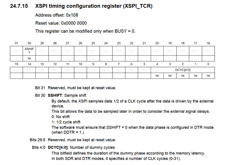

I'm working on a project using the STM32H7R3L8H6H MCU with a PSRAM chip connected via HEXASPI to XSPM1. I'm encountering massive issues with the PSRAM initialization, which I described in a different post. I found a discrepancy between the RM0477 Reference manual documentation and the STM32CubeProgrammer during my tests.
The XSPI_TCR register is described like this in the RM0477:

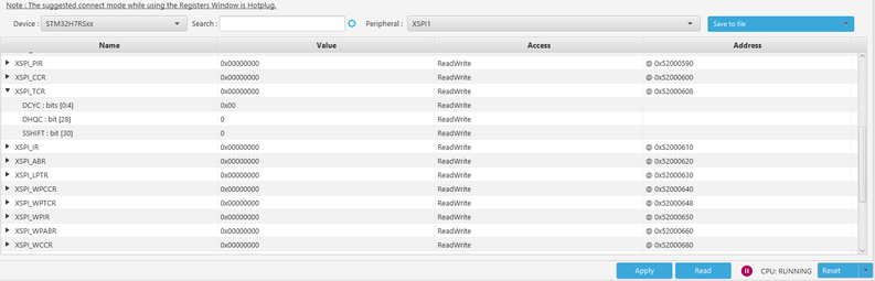

If I open the STM32CubeProgrammer register window, I find a DHQC flag on the register bit 28 position.
This bit is set to 1 all the time, and I have no information about its meaning.
Can someone please explain the function of this flag?

Hello @Intector,
The DHQC is not supported by the XSPI interface for STM32H7RS MCUs.
So, the RM0477 is correct and DHQC should be removed from bit list, STM32CubeMx XSPI parameter settings and STM32H7RSxx_HAL_Driver.

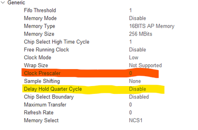

Hey @KDJEM.1
Thank you for that information. It'll probably cause less confusion if those settings for XSPI1 and XSPI2 are not available in MX:
Also, the Clock Prescaler settings shouldn't be in here because they're not used in the firmware.

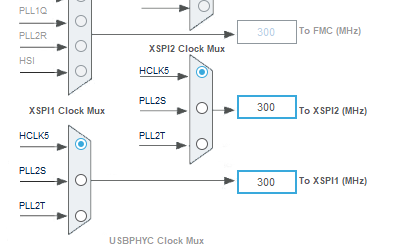

}The SAL_XSPI_SetClock function in the stm32_sal_xspi.c file calculates the Prescale Factor for the XSPI_DCR2 register. This calculation is based on the actual frequency input settings for the XSPIx. This always leads to a prescaler factor of "0," which is the original XSPIx input frequency.
If one selects those settings:
The memory connected to XSPI will probably not work. The poor soul will never know why because the function calls in extmem_manager.c looking like this:
EXTMEM_Init(EXTMEMORY_1, HAL_RCCEx_GetPeriphCLKFreq(RCC_PERIPHCLK_XSPI2));
EXTMEM_Init(EXTMEMORY_2, HAL_RCCEx_GetPeriphCLKFreq(RCC_PERIPHCLK_XSPI1));
