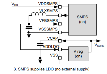

We also ran the same code on the discovery board using the default "Direct SMPS supply" configuration, where it successfully reduced power consumption to 80 µA. That's why we suspect that the higher current draw might be related to the "SMPS supplies LDO" configuration.
