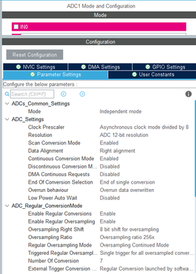

ADC1 clocked @ 65 MHz, pre-scaler of 8, 7 channels active, 640.5 cycles/conversion, 256 oversampling, interrupts, scan mode. The numbers suggest all channels will be converted 1x in (8/65000000) * 640.5 * 7 * 256 = 141 ms. But when I look at uwTick before HAL_ADC_Start_IT() and after 7 conversions complete, I get 37 ms. Why the discrepancy?

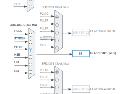

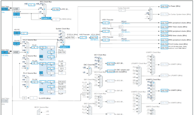

Are you sure the ADC clock is running at 65Mhz and not 250Mhz? If you're using cube, can you share a screenshot of your clock configuration? and ADC peripheral as well.

I don't see anything obviously wrong with your configuration. Can you post the entire clock screen? (PLL sections, HCLK).
This might happen if you set the HSE crystal frequency to the wrong value (e.g. you tell Cube you're using a 4Mhz crystal when in fact it is 16Mhz), so the PLL input frequency is actually 4x.

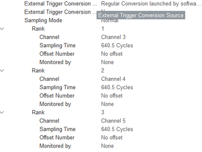

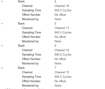

2024-07-10 8:53 AM
2024-07-10 10:37 AM
Verified HSE is 26 MHz
