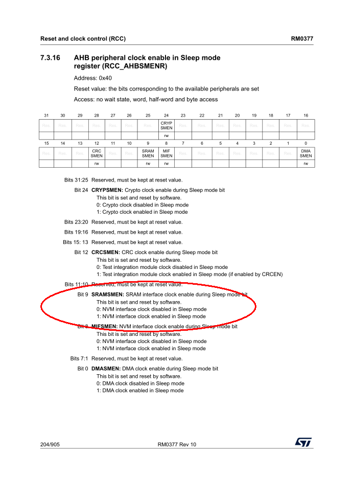

Unrelated, but I don't want to inflate the number of threads: obviously copy/paste error, description of this bit should not talk about NVM:

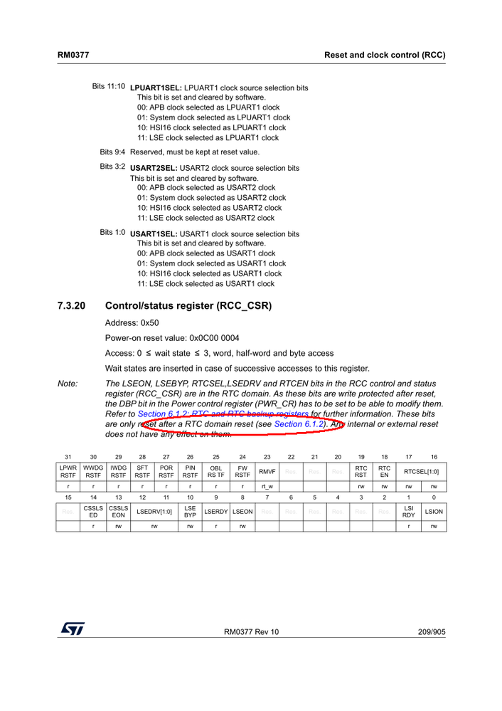

One more, again unrelated:
This is incorrect reference - the backup/RTC domain reset is described in chapter 7.1.3 RTC and backup registers reset .

Hi @Community member ,
I come back to this old discussion to confirm that following updates will be applied in RM0377:
Thanks for your continuous help to improve our deliveries.
