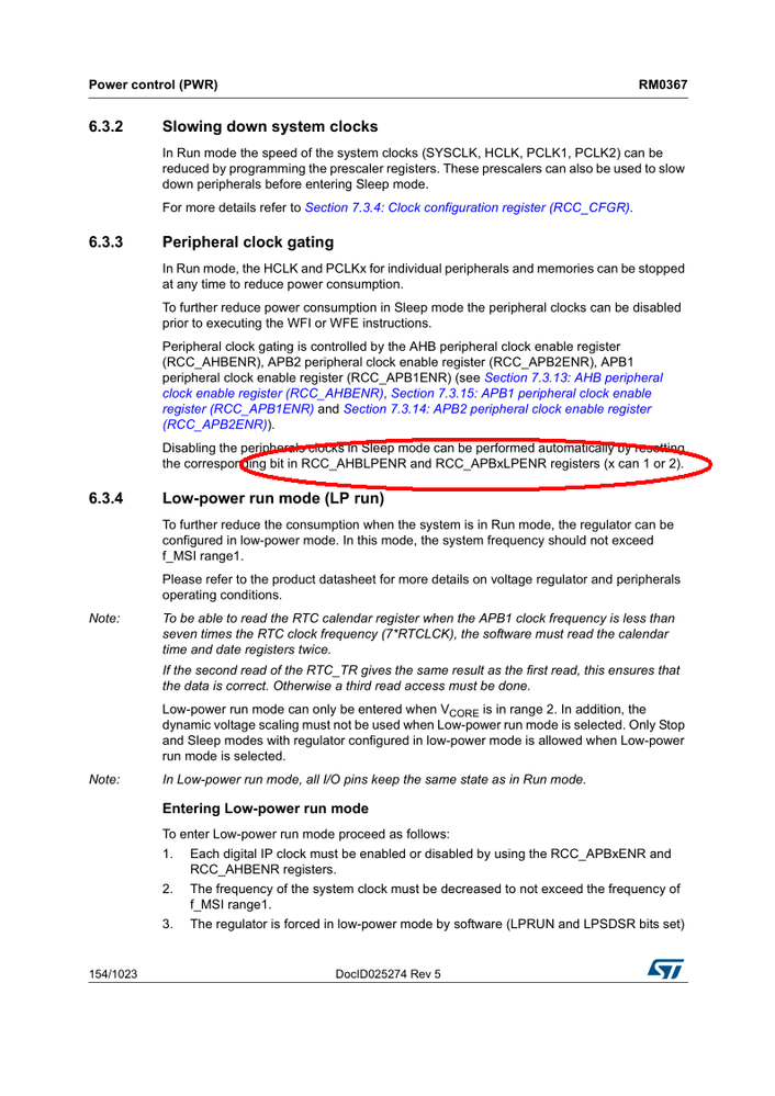

The nonexisting AxByLPENR registers are mentioned also in the 'L0 RMs, e.g.0693W000003BI45QAG.png
(note also the cumbersome "x can 1 or 2" formulation).
The reason for change probably is, that these registers function as *masks* to the "normal" AxByENR registers, contrary to the AxByLPENR registers in other STM32 models, which function as *replacement* of the "normal" AxByENR registers during appropriate lowpower modes.
However, I'm not sure if I am correct in this, as in the description of some of the AxBySMENR bits the reference to the "masking" is missing (CRC, SRAM, DMA, CRYPT,. NVM, SYSCFG). Also, it would be nice if this would be clearly described in the chapter the screenshot above is taken of.
