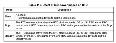

Indeed, as show in the table below (extract from RM0367), low power modes have no impact on RTC features and its registers that keep their values.
If it is the application that is reinitializing the wake-up timer after the wake-up from a low power mode, it should no longer do it.
