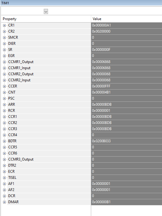

2021-09-17 1:12 PM
Here are the timer registers:
I have managed to change the symptoms by switching the polarity of:
sConfigOC.OCPolarity = TIM_OCPOLARITY_LOW;
sConfigOC.OCNPolarity = TIM_OCNPOLARITY_LOW;
This does not fully solve my issue though, because in this case, the PWMs have reverse polarity.
