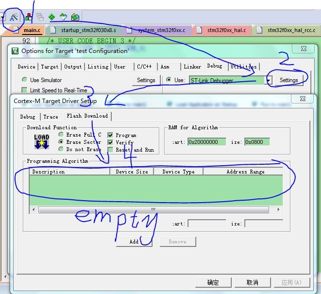

In the latest version of RM0360,Page 634,there is a mistake in the description of RTOF. RTOIE is not in CR2,it is in CR1 actually.No.2Chip type: F030C8T6Develop environment:KEIL v4.72 + CubeMX v4.11 + CubeF0 v1.4Debugger:ST-LINK V2 via. SWDAfter I choose toolchain as MDK V4 in CubeMX and generate the code,the option of ‘Programming Algorithm' in KEIL is empty. When I set it, the next code generation will erase this again.No.3Chip type: F103C8T6Develop environment: KEIL v4.72 + CubeMX v4.11 + CubeF1 v1.2Debugger:ST-LINK v2 via. SWDAfter I set the function of PA13 and PA14 as SWD in CubeMX and generate the code for MDK V4, the ort of debug option in KEIL is always set JTAG as default.No.2 and No.3 won't happen for KEIL v5.If there is something wrong above, please notice me.2015-11-03 8:02 AM

Thanks for all comments and your interest on our products and solutions. No.1Thanks for reporting this typo, it will be fixed in next versions of RM0360.No.2Could you please share a screenshot explaining the issue?No.3I confirm the issue. It is reported internally to take needed action to fix it.-Mayla-To give better visibility on the answered topics, please click on Accept as Solution on the reply which solved your issue or answered your question.

Here is the screenshot for issuse N0.2. Actually as you can see, I simulate this bug in KEIL v5, because I have uninstalled KEIV v4.72 as a result of this bug.It is quite same as shown in KEIV v4.72.2015-12-01 3:13 AM

Thank you for reporting these issues. They are solved in STM32CubeMX next release: 4.12.0.We’re moving the ST Community to a new platform to give you a better and more reliable community experience.
