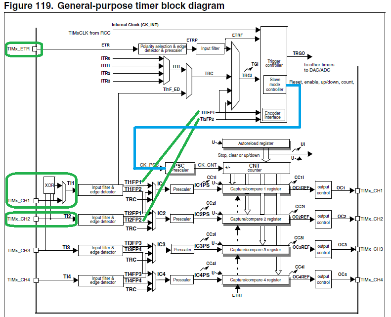

Im currently trying to read a incremental encoder via timer3 (channel3/4). Im working with a STM32F103RBTx.The encoder is connected to PC8 and PC9.If i connect the encoder to PC6 and PC7 (Tim3_CH1/2), then i can successfully read the encoder value. But since im going to use PC6/PC7 otherwise, im trying to do the same thing with Tim3_CH3/4. (Funny thing is, the encoder_counter can still be read on PC6/7 even if i configure GPIO PC8 and 9) Is there something missing? Here some code: /* Encoder: Enable and set TIM3 general Interrupt */ NVIC_InitStructure.NVIC_IRQChannel = TIM3_IRQn; NVIC_InitStructure.NVIC_IRQChannelPreemptionPriority = 0; NVIC_InitStructure.NVIC_IRQChannelSubPriority = 0; NVIC_InitStructure.NVIC_IRQChannelCmd = ENABLE; NVIC_Init(&NVIC_InitStructure); RCC_APB2PeriphClockCmd(RCC_APB2Periph_GPIOC, ENABLE); RCC_APB1PeriphClockCmd(RCC_APB1Periph_TIM3, ENABLE); RCC_APB2PeriphClockCmd(RCC_APB2Periph_AFIO, ENABLE); /* GPIO Configuration */ #define PORT_TI GPIOC #define GPIO_TI1 GPIO_Pin_8 #define GPIO_TI2 GPIO_Pin_9 /* Encoder: Configure PC8 and PC9 as input function */ GPIO_InitStructure.GPIO_Pin = GPIO_TI1 | GPIO_TI2; GPIO_InitStructure.GPIO_Mode = GPIO_Mode_IN_FLOATING; GPIO_InitStructure.GPIO_Speed = GPIO_Speed_50MHz; GPIO_Init(PORT_TI, &GPIO_InitStructure); GPIO_PinRemapConfig(GPIO_FullRemap_TIM3, ENABLE); //Ref. Man. p. 178 (DocID13902 Rev 15) void TIM_Configuration (void) { TIM_TimeBaseInitTypeDef TIM_TimeBaseStructure; /* 32bit Timestamp: Configuration of Timer2 for Slave */ TIM_TimeBaseStructure.TIM_Prescaler = 0; TIM_TimeBaseStructure.TIM_Period = 0xFFFF; TIM_TimeBaseStructure.TIM_ClockDivision = TIM_CKD_DIV1; TIM_TimeBaseStructure.TIM_CounterMode = TIM_CounterMode_Up; TIM_TimeBaseInit(TIM2, &TIM_TimeBaseStructure); // Select TIM1 Trigger Output as Trigger TIM_SelectInputTrigger(TIM2, TIM_TS_ITR0); // Slave Mode selection: Trigger on external Trigger TIM_SelectSlaveMode(TIM2, TIM_SlaveMode_External1); // Enable the TIM2 Master Slave Mode TIM_SelectMasterSlaveMode(TIM2, TIM_MasterSlaveMode_Enable); // TIM2 enable TIM_Cmd(TIM2, ENABLE); /* 32bit Timestamp: Configuration of Timer1 for Master */ TIM_TimeBaseStructure.TIM_Prescaler = 7199; // Prescaler = Teilerwert - 1 TIM_TimeBaseStructure.TIM_Period = 0xFFFF; TIM_TimeBaseStructure.TIM_ClockDivision = TIM_CKD_DIV1; TIM_TimeBaseStructure.TIM_CounterMode = TIM_CounterMode_Up; TIM_TimeBaseInit(TIM1, &TIM_TimeBaseStructure); // Master Mode selection: Output Trigger on Update (Overflow) TIM_SelectOutputTrigger(TIM1, TIM_TRGOSource_Update); // Select the Master Slave Mode: Output Trigger TRGO on TIM_TS_ITR0 TIM_SelectMasterSlaveMode(TIM1, TIM_MasterSlaveMode_Enable); // Clear Counters TIM_SetCounter (TIM1, 0); TIM_SetCounter (TIM2, 0); // TIM1 enable TIM_Cmd(TIM1, ENABLE); /* 32bit Encoder: Configuration of Timer3 in Encoder Mode */ TIM_TimeBaseStructure.TIM_Prescaler = 0; TIM_TimeBaseStructure.TIM_Period = 0xFFFF; TIM_TimeBaseStructure.TIM_ClockDivision = TIM_CKD_DIV1; TIM_TimeBaseStructure.TIM_CounterMode = TIM_CounterMode_Up; TIM_TimeBaseInit(TIM3, &TIM_TimeBaseStructure); TIM_EncoderInterfaceConfig(TIM3, TIM_EncoderMode_TI12, TIM_ICPolarity_Rising, TIM_ICPolarity_Rising); // Interrupt Flag löschen TIM_ClearITPendingBit(TIM3, TIM_IT_Update); // Enable Interrupt on update (under-/overflow of timer) TIM_ITConfig(TIM3, TIM_IT_Update, ENABLE); // TIM enable TIM_Cmd(TIM3, ENABLE); } void TIM3_IRQHandler(void) { // Aktueller Zählerstand static uint16_t counterValue; // Lesen des aktuellen Zählerstands counterValue = TIM_GetCounter(TIM3); if(counterValue < 0x8000) { // Nach Overflow werden die oberen 2 Byte inkrementiert TIM3CounterHighByte++; } else { // Nach Underflow werden die oberen 2 Byte dekrementiert TIM3CounterHighByte--; } /***************************************************************************** * Beispiel zur Anpassung der Auflösung des Encoders auf 24bit. *****************************************************************************/ /*if(counterValue < 0x8000) { TIM3CounterHighByte++; TIM3CounterHighByte &= 0x00FF; } else { TIM3CounterHighByte--; TIM3CounterHighByte &= 0x00FF; }*/ /* Clear TIM3 Trigger pending bit */ TIM_ClearITPendingBit(TIM3, TIM_IT_Update); }2015-11-30 5:42 AM
A whole bunch of imagined connectivity? The diagram for the TIM only shows routing for Channel 1 and 2 You should also qualify the source of interrupts, and clear them early in the handler, clearing them as the last thing before exit exposes you to a race hazard.2015-11-30 10:41 AM
hello clive
thanks for your response.where do you mean that the code is routing for channel 1 and 2? thats what im looking for, the route channel 3 and 4 instead.2015-11-30 10:50 AM
I'm saying there is no connectivity for channels 3 and 4 with respect to Encoder Mode.
2015-12-01 12:53 AM
ah thats it. thanks clive.
