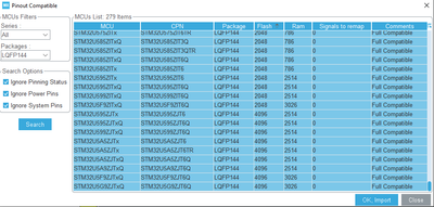

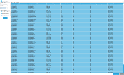

I suggest you use the CubeMX that will list pin-compatible parts (with flash and ram details of each MCU).
Load your chip, configure it if you want, then go to Pinout -> List Pinout Compatible MCUs:
Best Regards.
STTwo-32

Here are some STM32F4 that can do the job:
If you want to have more details, please refer to my first comment.
Best Regards.
STTwo-32
