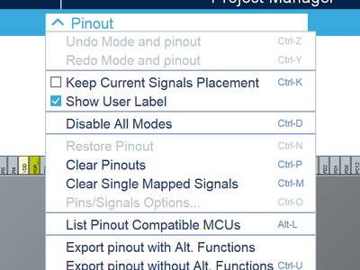

2025-08-18 8:31 PM
Use CubeMX to see pin compatibility between chips.
In short, they're not going to be pin to pin compatible. More than a few pins are different.
