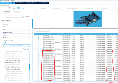

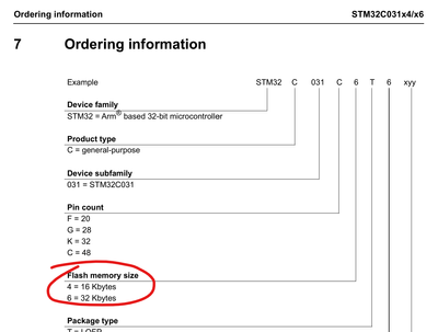

The STM32C031 is only available in 16 kB or 32 kB flash sizes.
The part selector in STM32CubeMX can help you narrow down and find a suitable chip. Here are STM32C0 chips with 64+ kB of flash.
Ultimately it depends on what your program does, but in most cases those will be able to run the same code without modification.

Hello @Ricko ,
The STM32C051G8U6 is the 64kB flash drop in replacement of STM32C031G6U6.
They are in the same series, so the package pinout, alternate function and platform are the same. The main differences are that in STM32C051G8U6 there are more flash and more peripherals.
