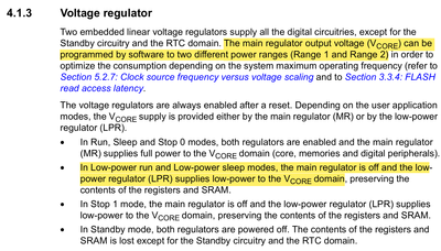

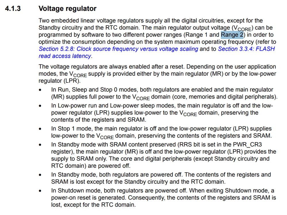

@Xme - more details of what regulators are used in which power modes here:
and here:

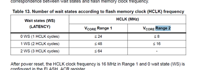

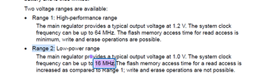

So what is difference?
it means that when I change voltage scaling to Range 2 while program runs, HCLK can be max 16Mhz .

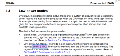

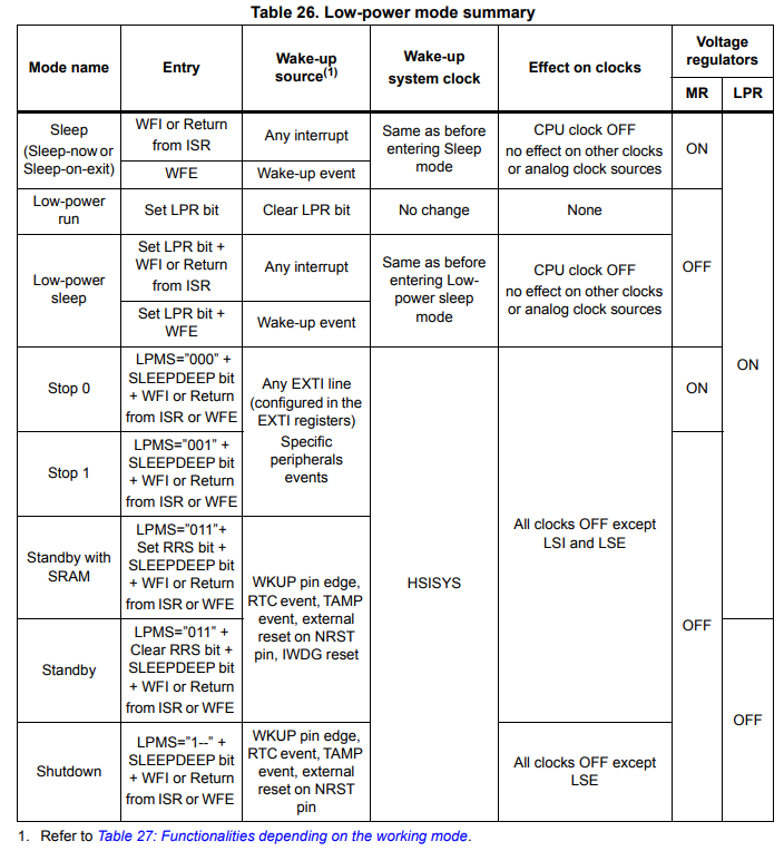

But when after this I want use WFI(), the HCLK must be 2MHz max ?
2025-04-15 6:09 AM
The MCU can be clocked from the normal regular (range 1 or range 2) or the low-power regulator (low power run mode).
Low-power run mode is a lower power consumption mode than either range 1 or range 2.
