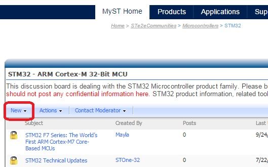

Alternately you can see if you have a ''Connect Under Reset'' option, either in IAR, or through the ST-LINK Utilities.Starting new threads, click ''New'' in top left immediately above the list of posts.2015-08-14 6:22 PM
