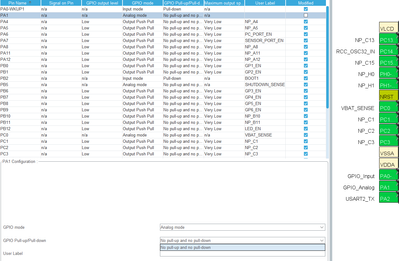

2023-10-04 7:38 AM - edited 2023-10-04 7:54 AM
Hi @KDJEM.1 ,
I'm using CubeMX and I set my unused pin PA1 to Analog and it is not permitting me to set a PU/PD.
You quoted section 6.1 in AN4899 which seems to make it clear that the pin must be PU/PD. In section 7.1, it says to set it as an Analog input which doesn't appear to have an internal PU/PD (see pic.). So now we're back to possibly having noise unless I connect an external PU/PD?
2023-10-04 11:55 PM
First of all, AN4899 contains additional information that applies to all STM32. Sections 6.1 and 7.1 refer to the already mentioned Schmitt trigger, which was connected to the GPIO by default in early families, but which could catch noise in floating mode because of its high impedance input, which can lead to higher current consumption. This is especially noticeable with ultra-low power derivatives. So if you activate the Analog Mode, the Schmitt Trigger is prevented from capturing noise. Nevertheless, it can be useful to terminate the input pins cleanly, which can also include an external pull down. Connecting the pin directly to GND is, as already discussed, not a good idea.
The second point is a special feature of the STM32G4, whose GPIO actually allows a pull down in GPIO_Analog mode (see RM0440, section 9.3.12), which is reflected in the corresponding configuration table (see RM0440, table 56, MODE=0b11). Important detail added so far only for this family, mentioned in the third bullet: The weak pull-up is disabled by Hardware. The weak pull-down is configurable.
I suspect that this feature has been forgotten in CubeMX, which is why currently no pull-down can be selected. But as a workaround you can reconfigure the pin in the user code using GPIOx_PUPDR.
