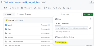

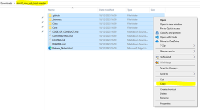

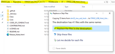

Hi @MMARI.1 ,
Go on the GitHub - STMicroelectronics/stm32_mw_usb_host: Provides the USB Host library part of the STM32Cube MCU Component "middleware" for all STM32xx series and download as zip.
Unzip the files and copy all folders to \Repository\STM32Cube_FW_F7_V1.17.1\Middlewares\ST\STM32_USB_Host_Library by replacing the old files.
Then, open your HID_Standalone project in Repository\STM32Cube_FW_F7_V1.17.1\Projects\STM32F722ZE-Nucleo\Applications\USB_Host\HID_Standalone and Run.
I hope this help you.
Thank you.

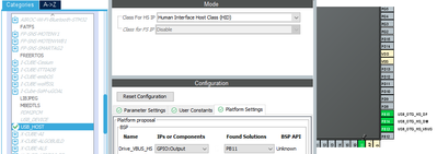

2024-05-02 9:49 PM
2024-05-03 12:04 AM
Hi @MMARI.1 ,
Thank you.
Kaouthar

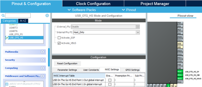

2024-05-03 2:44 AM
hi, after USB middleware update keyboard started working with USB_FS via PA12 & PA 11.
then i disabled USB_FS (pin PA12 & PA 11) and enabled Internal_Phy_Fs via PB15&PB14 found keyboard not working .
i need 2 USB_FS line for different purpose
