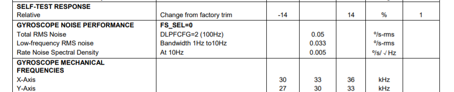

This doesn't look to be corrupted data during tranfer but sensor noise. Thus, for answer you have to resort to the sensor's datasheet/manual.
2020-01-26 4:02 AM
Hi @Community member , thank you for your quick reply.
Sorry again for the stupid question.
Are you maybe referring to this?
If yes, could you please indicate me how to proceed?
Thank you again for your precious help.
2020-01-26 4:44 AM
I'm not familiar with gyro/accelerometers, sorry.
Generally, you cope with sensor noise by filtering, of which the sliding average is the simplest one. It's then the matter of tradeoff between response/speed and precision, how many values you want to include in the average.
