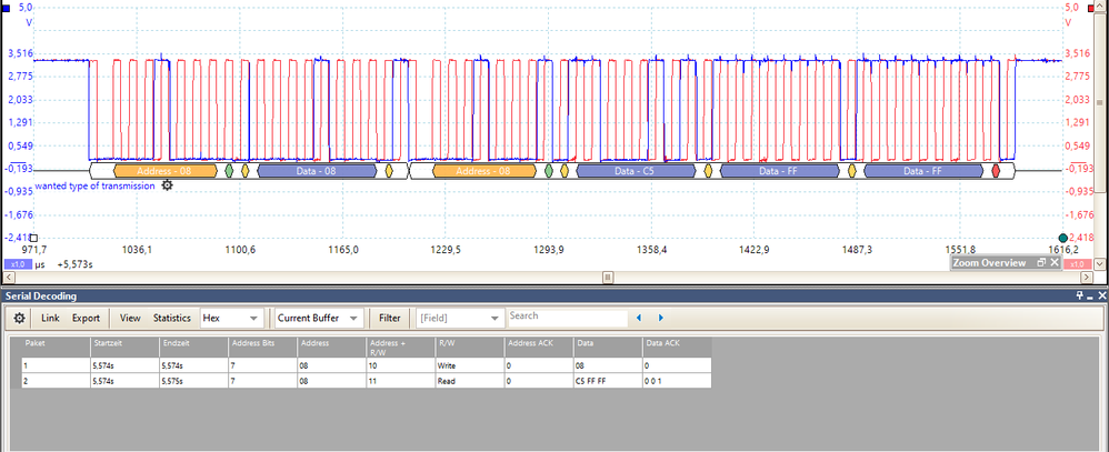

Short version of the question: How can I achieve a response like shown in the first picture from the slave device, without getting stuck in an error. This response is from the specific slave device, but I can only generate it once. After that the STM is stuck in an error.

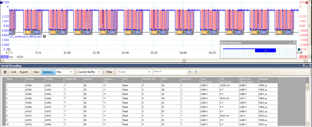

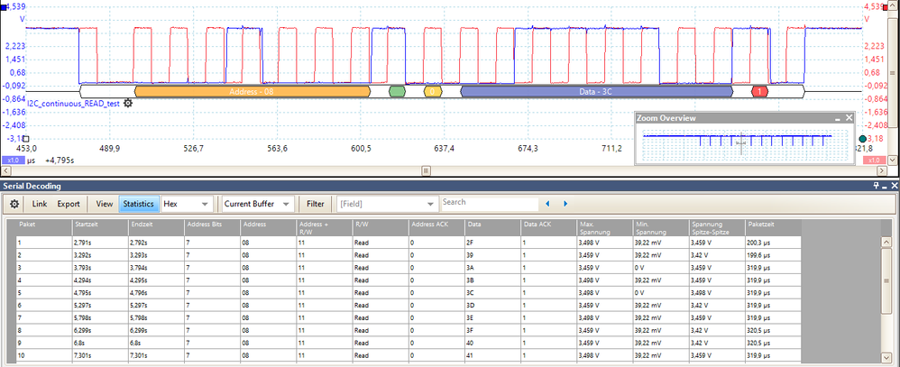

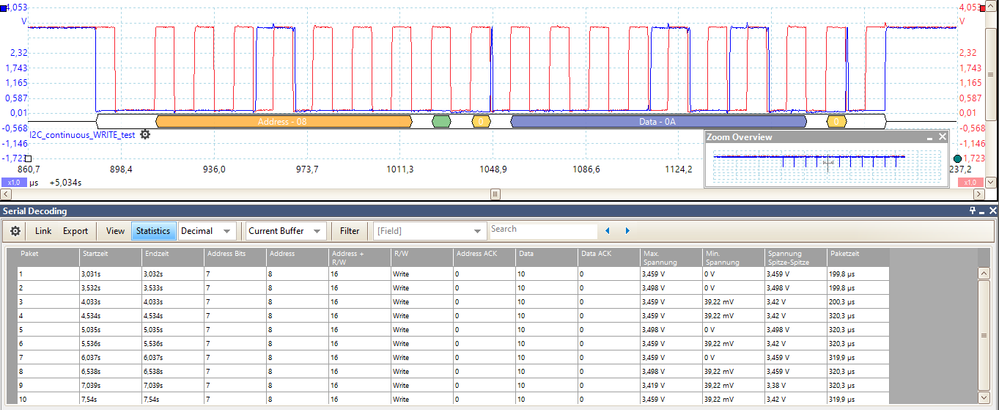

At this point the master could “continuously�? send data to or read data from the slave, but still only one of them at a time. I still haven’t found a way to switch between them, without getting stuck in the while loop. Wouldn’t this destroy the whole point of interrupts and just load the MCU? Or am I wrong with this point? Isn’t there any intended, correct way to do this? Below are some pictures of the output of the logic analyser. To me it seems everything quite ok.
Master write - slave receive
Master read - slave transmit
master read - slave transmit without any programmed delay in master

1.Is the shown message I want to achieve just related to SMBUS and ordinary I2C can’t hand it?
