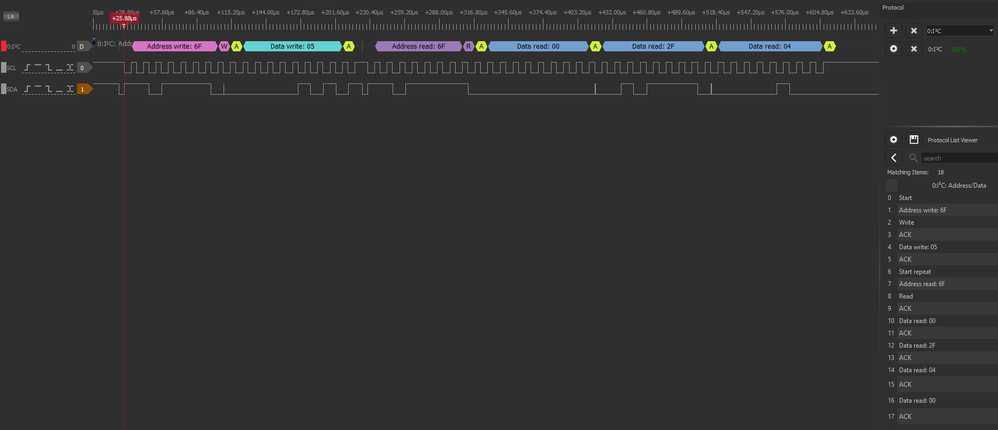

Here is good communication packet.
I receive:
S-Address-W-A-Command-A-
P
-S-Address-R-A-Data-nA-Puint8_t I2C_read_brekeke(I2C_TypeDef *I2Cx, unsigned char Address, uint8_t reg, int nBytes, unsigned char *data)

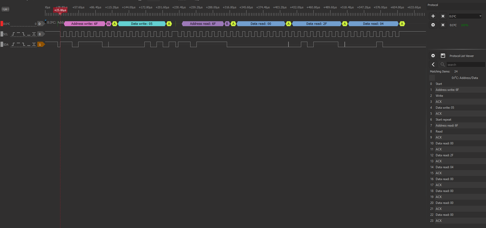

Hello friends.
This code working fine only for reading two byte.
But when I read 3 bytes I have big problem. I don't send stop bit:

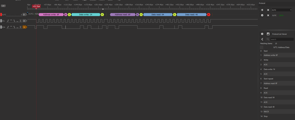

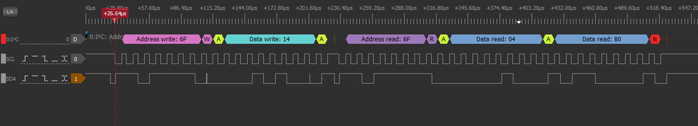

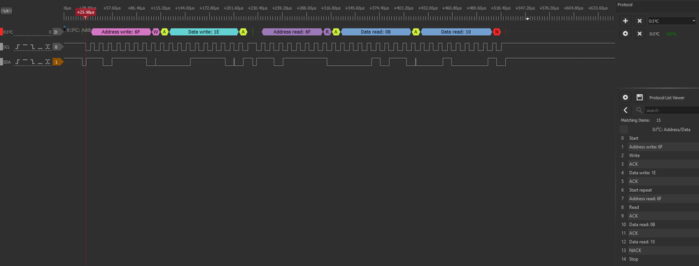

}READ 2 bytes is good:
READ 3 bytes is bad:

I'm looking in the registers.
And:
When I receive 2 bytes (when all is good) register ISR is set:
ADDCODE - 0x00
ADDR - 0x00
ALERT - 0x00
ARLO - 0x00
BERR - 0x00
BUSY - 0x00
DIR - 0x00
OVR - 0x00
PECERR - 0x00
RXNE - 0x00
TC - 0x00
TCR - 0x00
TIMEOUT - 0x00
TXE - 0x00
TXIS - 0x00
When I receive 3 bytes (read is wrong) register ISR is set:
ADDCODE - 0x00
ADDR - 0x00
ALERT - 0x00
ARLO - 0x01
BERR - 0x00
BUSY - 0x01
DIR - 0x00
NACKF - 0x01
OVR - 0x00
PECERR - 0x00
RXNE - 0x00
STOPF - 0x00
TC - 0x00
TCR - 0x00
TIMEOUT - 0x00
TXE - 0x00
TXIS - 0x00
In datasheet is writing:
ARLO - This flag is set by hardware in case of arbitration loss. It is cleared by software by setting the ARLOCF bit.
BUSY - This flag indicates that a communication is in progress on the bus. It is set by hardware when a START bit is detected. It is cleared by PE=0 or when STOP bit is detected.
STOPF - Stop bit detection
2018-03-08 2:14 AM
Arbitration loss indicates that something is wrong with that last NAK (and the picture indecates the same).
Try decrease pullups on SDA, increase timing, and observe with oscilloscope.

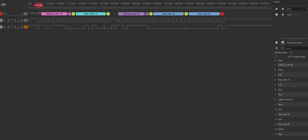

I try this function. It is working only, when I am going to receive 2 bytes.
When I am receiving 1, 3, 4 bytes it is not working.
