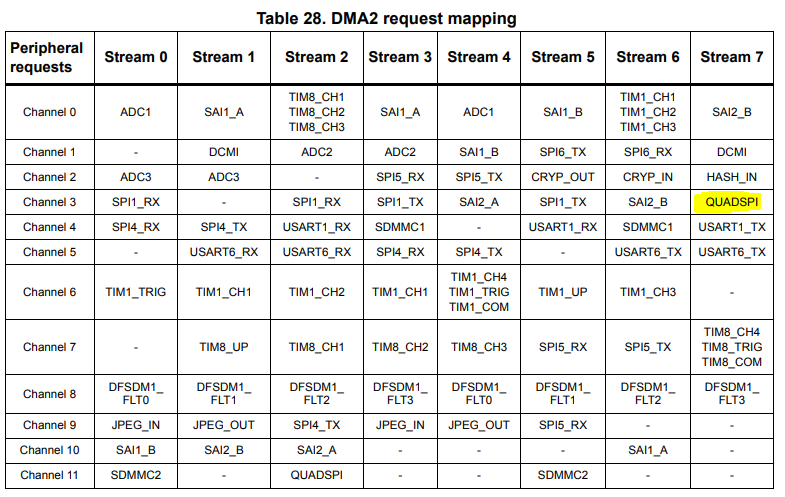

I have a problem. I have this function:
/*instruction = 0x0B - Fast read
* addr = address (0x00) - address
* count = number of read data (4bytes)
* dst = data out */
void QSPI_fast_read (uint8_t instruction, uint32_t addr, size_t count, uint8_t *dst)
{ /* Quad Command Fast Read (QCFR), instruction, address, data use 2 lines * Adresa: 24 bits (3 bajty - viz QUADSPI_CCR_ABSIZ) * read: byte (count) * * Read with DMA, mez FIFO = 1 * DMA2, Stream 7, Channel 3 */ DMA_Stream_TypeDef *stream = DMA2_Stream7; LL_AHB1_GRP1_EnableClock(LL_AHB1_GRP1_PERIPH_DMA2); stream->CR = 0;stream->CR =
(0x03 << DMA_SxCR_CHSEL_Pos) | // channel id = 3 (0x00 << DMA_SxCR_MBURST_Pos) | // MemBurst 0x0: single transfer, 0x1: burst of 4 beats, 0x2: burst of 8; 0x3: burst of 16 beats (0x00 << DMA_SxCR_PBURST_Pos) | // PeriphBurst 0x0: single transfer, 0x1: burst of 4 beats, 0x2: burst of 8; 0x3: burst of 16 beats (0x03 << DMA_SxCR_PL_Pos) | // priority level (0 lowest; 3 highest) (0x00 << DMA_SxCR_MSIZE_Pos) | // 8 bit source memory (0x00 << DMA_SxCR_PSIZE_Pos) | // 8-bit target register (1 * DMA_SxCR_MINC) | // memory increment (0 * DMA_SxCR_PINC) | // no periph increment (0x00 << DMA_SxCR_DIR_Pos ) | // direction 0: P->M, 1: M->P (0 * DMA_SxCR_PFCTRL) | // 0 - DMA is the flow controller, 1 - periph is the flow controller (0 * DMA_SxCR_EN);stream->M0AR = (uint32_t)dst; /* mem address */
stream->PAR = (uint32_t)&QUADSPI->DR; /* periph address */ stream->NDTR = count;QUADSPI->FCR = -1; // clear all flags
QUADSPI->DLR = (count-1); //data lenght QUADSPI->CCR = (0 << QUADSPI_CCR_DDRM_Pos) | // disable DDR mode (0 << QUADSPI_CCR_DHHC_Pos) | // delay the data output using analog delay (0 << QUADSPI_CCR_SIOO_Pos) | // send instruction for each command (0) or only for 1st command (1) (0x01 << QUADSPI_CCR_FMODE_Pos) | // Functional mode; 0 : indirect write, 1 : indirect read, 2 : autopolling, 3 : memory-mapped (0x01 << QUADSPI_CCR_DMODE_Pos) | // Data mode: 0 : no data, 1 : data on single line, 2: data on dual line, 3 : quad line (0x07 << QUADSPI_CCR_DCYC_Pos) | // number of dummy cycles, 0..31 (0x00 << QUADSPI_CCR_ABSIZE_Pos) | // alternate byte size; 0: 8-bit, 1: 16-bit, 2: 24-bit, 3: 32-bit (0x00 << QUADSPI_CCR_ABMODE_Pos) | // alternate bytes mode; 0: no alt bytes, 1 : on single line, 2 : dual line, 3 : quad line (0x02 << QUADSPI_CCR_ADSIZE_Pos) | // address size; 0: 8-bit, 1: 16-bit, 2: 24-bit, 3: 32-bit (0x01 << QUADSPI_CCR_ADMODE_Pos) | // address mode; 0: no address, 1 : on single line, 2 : dual line, 3 : quad line (0x01 << QUADSPI_CCR_IMODE_Pos) | // instrustion mode mode; 0: no instruction, 1 : on single line, 2 : dual line, 3 : quad line (instruction << QUADSPI_CCR_INSTRUCTION_Pos); // instructionQUADSPI->CR |= QUADSPI_CR_DMAEN; //enable read DMA
stream->CR |= DMA_SxCR_EN; QUADSPI->AR = addr; //write to address register, when ADMODE != 0 and FMODE = 1. while (!(DMA2->HISR & DMA_HISR_TCIF7)) {}; //wait to the end of DMA DMA2->HIFCR |= DMA_HIFCR_CTCIF7; stream->CR &= ~DMA_SxCR_EN; SCB_InvalidateDCache_by_Addr ((uint32_t*)dst, count); // reset cache QUADSPI->CR &= ~QUADSPI_CR_DMAEN; //the end read of DMA}And i have a problem with this line:
My program is waiting on 'while'. And I can't find a solution of this problem. Any idea, what is wrong?
But, I check the communication. And you can see,
Do you see anything wrong?
2018-02-09 6:13 AM
Read the errata - there are two significant problems with QSPI, which may affect your piece of code. Don't use dummy bytes.
