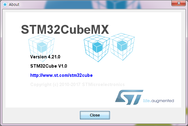

2017-06-15 6:45 AM
First of all, thank you for your answer.
I just upgraded the CubeMX as advised
and tested the Ethernet communication after fixing some minor compilation errors.
But the situation is the same.
