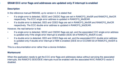

Hello @harisuvarna
Check the STM32U5 Errata, you may have the same condition described in section: SRAM ECC error flags and addresses are updated only if interrupt is enabled.

Hi Iman,
Thank you for the response. I do enable RAM ECC interrupts in register RAMCFG_MxIER.
Section 6.3.2 of ST User Manual (RM0456) says following
But ECCE bit is not automatically set even though SRAM ECC is enabled in FLASH_OPTR.
