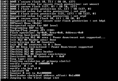

Hi I am working on SBSFU Application project from STM32U585 project. I have done below changes to the existing project.
1. Added my project code SBSFU_Appli_NonSecure project.
2. Previously this project was assigned 192KB and it was hardly using 3% of it. And now the requirement is of more RAM, I have increased RAM boundry to 256KB as below in STM32U585AIIX_FLASH.ld
RAM (xrw) : ORIGIN = NS_DATA_START, LENGTH = 256KB/*NS_DATA_SIZE*/
3. Now what I am seeing is I am not getting to jump to NS main() after this
"[INF] Jumping to the first image slot"
Same kind of experiment I have tried in TFM project and it worked, but I am not able to get the catch here.
Need help, thanks in advance...

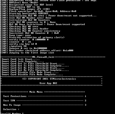

2024-09-03 11:05 AM
Hi Jocelyn, thanks for details support. I have followed as you have mentioned and now I am able to accommodate my application into SRAM3. Compilation is happening successfully. And I could see build analyzer.
But when I run my application I still see my code is not jumping into application.
While with SRAM1 usage my application works file(limited the RAM usage)
Any idea about this.
Thanks,
Nitin

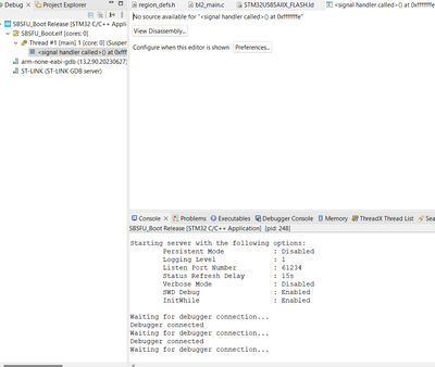

2024-09-04 2:45 AM
Hello Nitin,
I provided the changes needed that should make your project work.
Please attach the debugger to the target without downloading anything, just symbols to understand where it fails
Best regards
Jocelyn

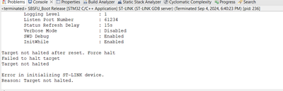

2024-09-04 6:15 AM - edited 2024-09-04 6:31 AM
Hi Jocelyn, since past two months we are not able to debug TFM /SBSFU projects and we are getting errors. We have tried with multiple debuggers and devices.
or
We have followed below link initially, then we were able to debug, but now it's not happening.
