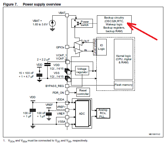

The SRAM at power up has undefined content. Certain STM32 parts have registers or RAM areas backed up by the battery in the VBAT power domain.2013-04-04 7:13 AM

And if power lacks, the SRAM is scrambled, but my booter has a main boot address in Flash (pointing to a firmware I know to be working), so I'm also good. But what you say is interesting : what do you mean, Vbat power domain backup ? How can it backup anything if there's no power anyway ?2013-04-04 7:29 AM
With no power you'll need to use FLASH. If you have a battery or supercap, use that to preserve across a cycle in the primary supply.
