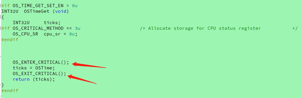

Hi,Master:
Question 1:
As shown in the figure below, why does the api read this variable with critical protection?
Question 2:

2021-11-18 5:50 AM
1) It is unnecessary as reading int32_t is atomic. You would need to ask the author why it's there.

2021-11-19 2:55 AM
Lacking additional context I'd assume this is coded to handle a 16-bit (or 8-bit) MCU
2021-11-19 5:20 AM
I've never seen OS_ENTER_CRITICAL() / OS_EXIT_CRITICAL().
By searching on Internet I see these functions seem related to uCOS and not related to STM32 specifically.
