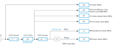

Stm32G071. I checked systick in software and the debugger and it's 15999. I want to believe it's an illusion on my oscilloscope but the fact that setting the period to 500 works is confusing.
2025-06-25 6:31 AM
Setting to 500 instead of 499 works? What is the time scale on the plot? Which clock is "correct" and which is not?
Show the clock configuration tab.
To me, looks like one clock is 2x the speed of the other clock which is easily explained by a misunderstanding somewhere.
2025-06-25 6:56 AM
That's just the way I have tested.
In my scheduler I set and output at the beginning and clear the output at the end of the 5ms task. That task is based on the Systick.
The other is Tim3 which is a center aligned PWM that I trigger an interrupt with. I don't actually use the PWM output. I toggle a port inside of its interrupt.
Timing is not 2x what I want. Time is correct but one is slightly off. At these speeds I don't think I have any accurate way to know which timer is correct.
I also had a long argument with ChatGPT about this. It was unable to conceptualize that 500 is aligned and 500-1 is not. I'm expecting to learn something new here because I don't see how this can be happening. Out of phase, yes. Drift, no. Unless I am programmatically changing a timer somewhere.

Time to check the actual ARR and systick register settings.
Can't always trust Cube. Although this one is surprising.
