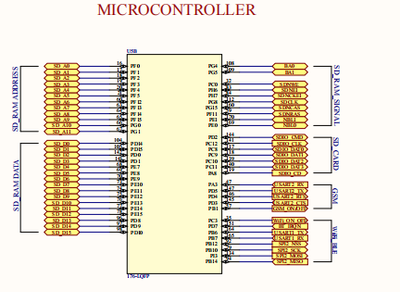

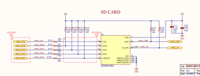

sd card scematic (part number-GTFP08431BEU)
Microcontroller scematic -

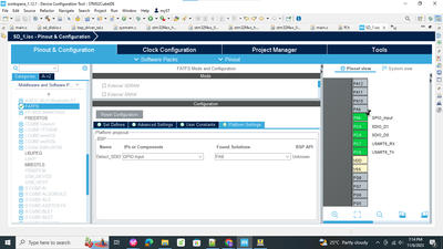

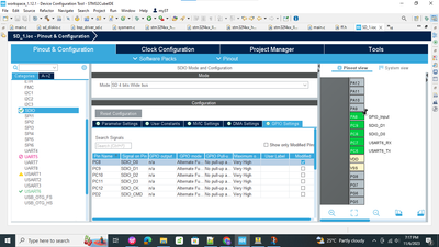

.IOC file pictures of:
- FATFS Platform settings
- SDIO GPIO settings

sd card schematic-
SDIO GPIO Setting
