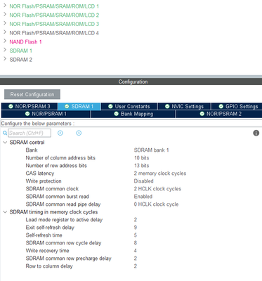

2023-11-03 10:15 AM
Here is the CubeMX Setting which were used for this test.
@Tesla DeLorean see if you can think of some setting which we might be overlooking here.

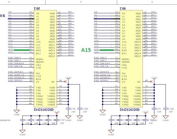

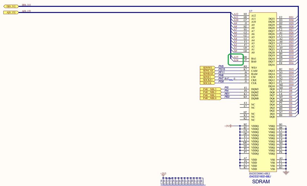

2023-11-03 10:25 AM - edited 2023-11-03 10:40 AM
https://www.mouser.com/datasheet/2/198/42-45R-S_86400D-16320D-32160D-258456.pdf
Suspect the banking is handled incorrectly
FMC_A14/FMC_BA0
FMC_A15/FMC_BA1
These might be usable interchangeably but I think you'll need to change the A13 pin to use A15 as a source instead.
2023-11-03 10:44 AM
Thanks, let me try updating that and see if that can make any difference.
2023-11-03 10:51 AM - edited 2023-11-03 10:51 AM
On the BA0/BA1 side for the SDRAM, I don't suppose which 16MB bank matters to the STM32 provided that it decodes consistently
ie, these will be functionally equivalent
BA0 = A14, BA1 = A15
BA0 = A15, BA1 = A14
In terms of modding the circuit to check, changing one wire seemed the easier option.
2023-11-03 11:38 AM
you mean
SDRAM1
A13-----> BA0
A14-----> BA1
SDRAM2
A14-----> BA0
A13-----> BA1
2023-11-03 11:56 AM
No, I mean the bank ordering [0..3] doesn't particularly matter
STM32 A14 = BA0
STM32 A15 = BA1
You've involved STM32 A13, and I don't think that's correct. As you've got A14 already wired to one of the bank pins my suggestion to test was to cut the wire to the other currently carrying A13, and connect that to A15 instead.
I don't see enough of the circuit/schematic to gauge the difficulty to achieving that.

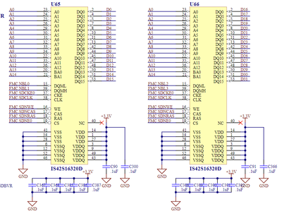

2023-11-03 12:07 PM
Hi Tesla DeLorean,
i am attaching a new png file where my A15 is connected to the SRAM. if that won't cause any issues I can modify the change.

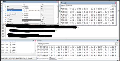

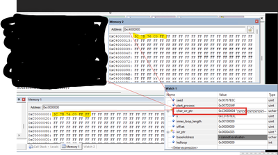

2023-11-03 2:06 PM
after doing the change to one SDRAM (SDRAM2) we were only able to memset to 0XFFFFFFFF half the memory of SDRAM2 as shown below
do i need to make the change for both the SDRAMS? as you mention A13 is not a bank pin
how to memset the entire memory?
when i am trying to write the SDRAM1 at address 0X0C00000. i can see that some of the data is getting written on address 0X0C10000.
