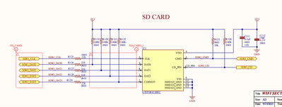

sd card scematic (part number-GTFP08431BEU)

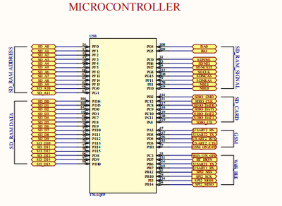

Microcontroller scematic -
