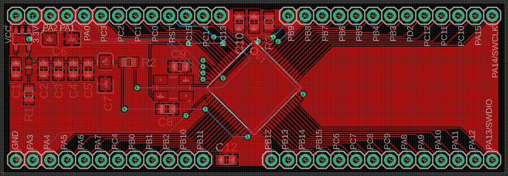

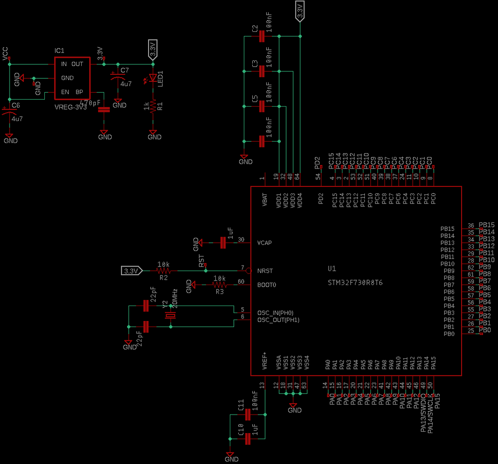

So, I attempted to make a breakout board for the LQFP64 package of the STM32F730R8 and I can't seem to get it to work somehow. Whenever I try to upload a program to it, I get a "No device found on target". If anyone has an idea or pointers, that would be very helpful!
Here's the relevant info:
I tested the obvious, supply pins and grounds are right on my DMM and my SWD pins are connected properly.
Here's the schematics and the layout. Please be gentle, I am not a professional.

On that chip, the VREF+ pin is the same as the VDDA pin. It needs connected to VDD.
The bypass caps could be closer to the chip, but probably not a problem.

Since the VREF+ pin is connected through a via, I could use a jumper wire to connect it to VDD and ST-Link Utility now recognized the chip so that seems that it may have done the trick.

Should probably rename that pin to VDDA in the schematic, since that's its main function.
