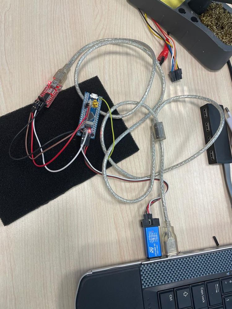

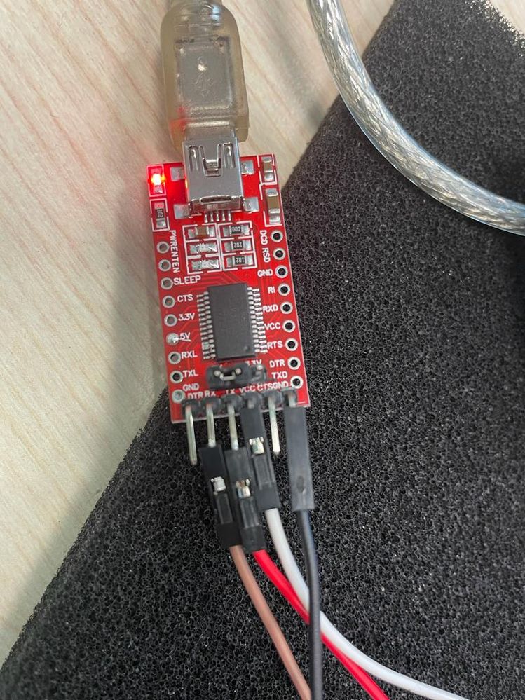

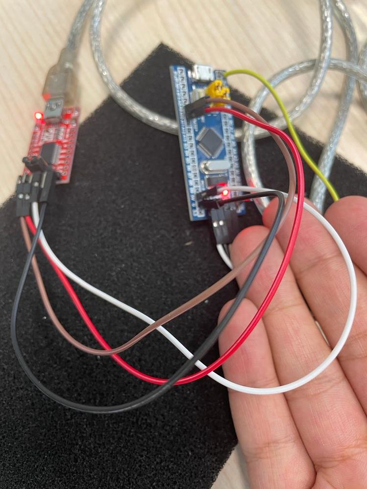

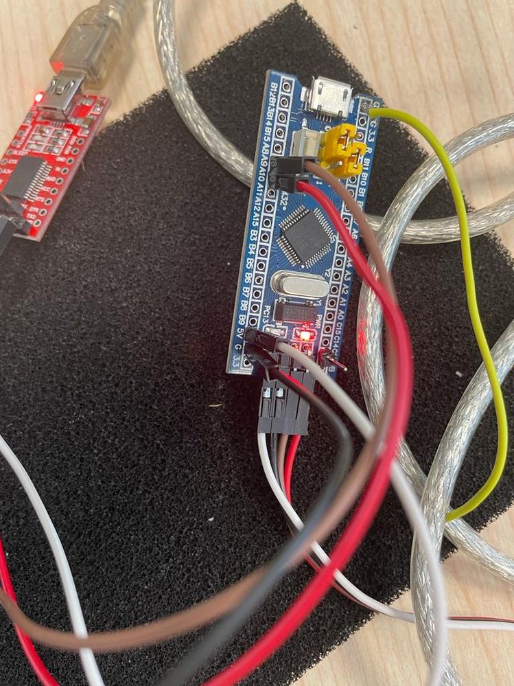

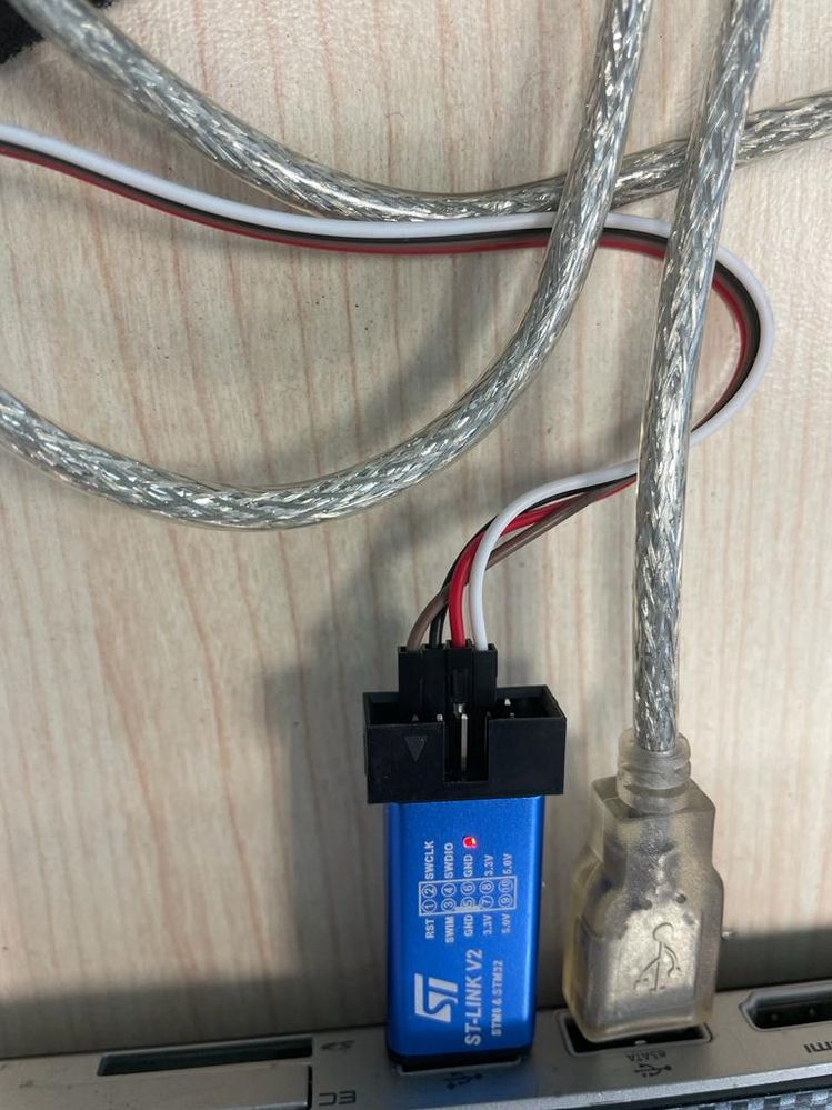

Nowadays I am trying to send and receive data with STM32f103C8 module. In fact, my aim is only write" Hello World " one after the other in the rows below at Tera Term, by coing at STM CubeIDE, and with my some hardwares. So , first I connected this STM32f103C8 module to an FTDI programmer module and ST-Link V2. By watching some videos, I connected these 3 products's pins:
STM32F103C8's Rx to FTDI's Tx,
STM32f103C8's Tx to FTDI's Rx ,
Ground to Ground,
STM32F103C8's 5V to FTDI's VCC pin, then, same legs of STM32F103C8's and ST-Link are connected to each other.

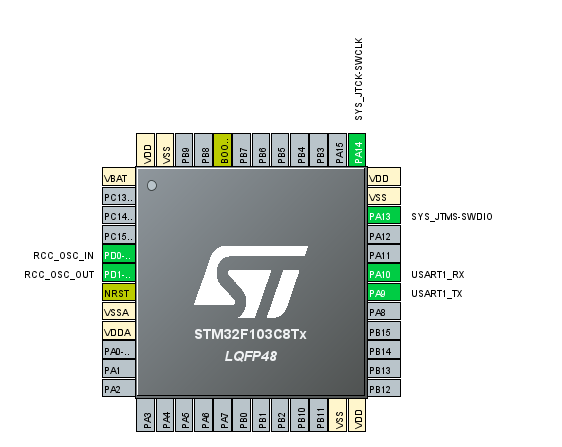

I used STM CubeIDE as developement environment, and Tera Term application to test it. When I build the project at STM CubeIDE, I get no error, but then When I Debug, then Resume(F8), there is no joy at Tera Term, and at STM CubeIDE a new page is openning named 0x1fffe61c which has explanation " Break at address "0x1fffe61c" with no debug information available, or outside of program code." inside this page.
Note : Baudrate is 115200 at both STMCubeIDE pinout configuration and Tera Term serial port settings.

#endif /* USE_FULL_ASSERT */I added the photos that show how to I connected the pins to each other and my laptop.
2022-05-31 6:16 AM
The 0x1fffe61c address suggests it is trying to run from ROM, rather than your code in FLASH.
Make sure BOOT0 is LOW

Also note that your "ST-Link" is a clone - not a genuine ST product
2022-06-01 12:02 AM
My BOOT0 was High, bringing it to the LOW solved the issue, thanks for your answer @Community member . I wish you the best.:smiling_face_with_smiling_eyes:
