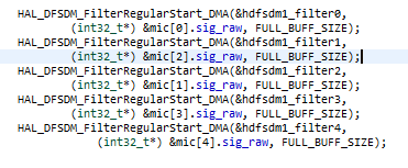

Now I'm wondering if transfer via BDMA requires some different kind of handling. Because now even though I configured it in Circular Mode, BDMA1_IRQHandler fires only once.
Now I'm starting all channels with the same HAL function (filter 0,1,2,3 uses DMA and filter 4 uses BDMA).
HAL_DFSDM_FilterRegularStart_DMA(&hdfsdm1_filter0,
(int32_t*) &mic[0].sig_raw, FULL_BUFF_SIZE);
HAL_DFSDM_FilterRegularStart_DMA(&hdfsdm1_filter1,
(int32_t*) &mic[1].sig_raw, FULL_BUFF_SIZE);
HAL_DFSDM_FilterRegularStart_DMA(&hdfsdm1_filter2,
(int32_t*) &mic[2].sig_raw, FULL_BUFF_SIZE);
HAL_DFSDM_FilterRegularStart_DMA(&hdfsdm1_filter3,
(int32_t*) &mic[3].sig_raw, FULL_BUFF_SIZE);
HAL_DFSDM_FilterRegularStart_DMA(&hdfsdm1_filter4,
(int32_t*) &mic[4].sig_raw, FULL_BUFF_SIZE);Unfortunately, I wasn't able to find any examples of using BDMA.

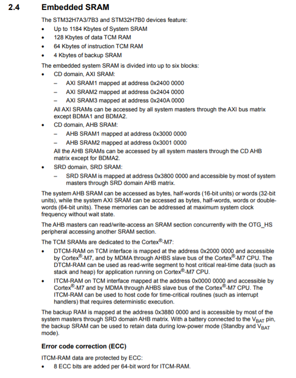

I can't find such info in the reference manual you linked for my MCU - STM32H7A3.
Here is page 135 from this manual.

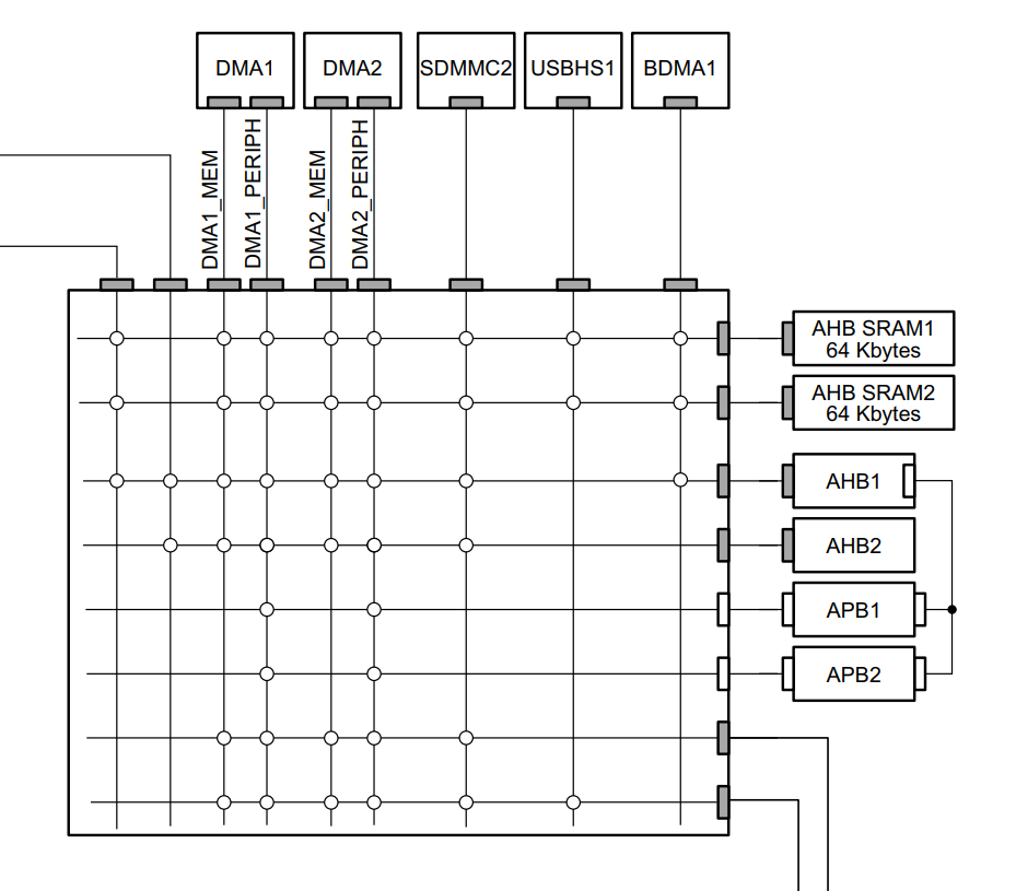

From this words:
"embedded system SRAM is divided into up to six blocks:
• CD domain, AXI SRAM:
– AXI SRAM1 mapped at address 0x2400 0000
– AXI SRAM2 mapped at address 0x2404 0000
– AXI SRAM3 mapped at address 0x240A 0000
All AXI SRAMs can be accessed by all system masters through the AXI bus matrix except BDMA1 and BDMA2.
• CD domain, AHB SRAM:
– AHB SRAM1 mapped at address 0x3000 0000
– AHB SRAM2 mapped at address 0x3001 0000
All the AHB SRAMs can be accessed by all system masters through the CD AHB matrix except for BDMA2."
I deduced that I should put data in AHB SRAM, as I am using BDMA1.
Statement you just mentioned "AHB SRAM1 is accessible by all system masters except BDMA through D2 domain AHB matrix." I could find in the reference manual for MCU - STM32H750VBT6.

Hi Natan,
Yes you are right, sorry for the conflict.
You can use AHB SRAM for STM32H7A3 devices.
For more details, you can refer to this FAQ, taking in consideration that for STM32H7A3 devices there are only 2 domains ( we can say that D1 and D2 are merged into only one domain, and D3 is maintained as SRD Domain, compared to STM32H743/753/750 devices).
Therefore, there is no problem with your linker file since the memory you chose is accessible by both DMA and BDMA.
