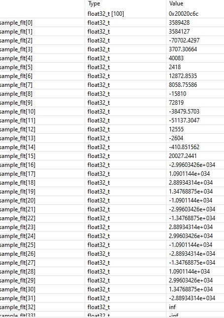

Some additional context about what is weird, I expected to get the real portions stored in sample_flt and the imaginary portions stored in fft_out_buf, which I believe how this code works (or at least how it appeared to work in other code).
What was odd about this is that I received 16 "normal sized" real samples in sample_flt (without exponents), 16 additional real samples (with exponents in the xxxxe+034 range), and then the rest seemed to vary between the inf, -inf, and nan.
For the imaginary portion, I received two "normal sized" imaginary samples and the rest were all nan.
I expected I might have some differences between octave and this that I might need to resolve/understand, but it seems odd to have such massive differences, which makes me think I am doing something wrong. What's odd is this doesn't seem to be a particularly complicated function so I'm not entirely sure what the core of the issue is.
For reference, here's what Octave provided:0693W00000DmTd0QAF.jpg
Here's the real portion (sample_flt):
Here's the imaginary portion (fft_out_buf):

No, nan stands not for a complex number. There is no complex hardware data type on STM32. Complex numbers are stored as two consecutive real number (re+im part). Are the arrays global (static) variables? Otherwise it could be a stack overflow.

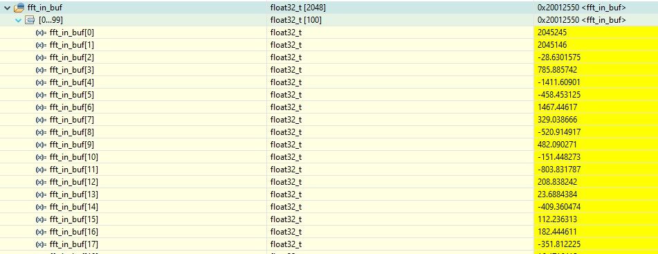

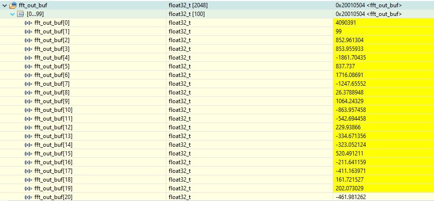

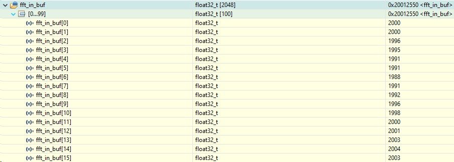

I then put in a 2.2khz tone into the mic (which I can only assume is the same frequency modems used back in the day by my ears) and ran through the code. It appears to be working as expected, even with my changes (it had an external GUI for doing a spectrum analysis and it analyzed the core frequency spike correctly, which is good).
This is the data before running the FFT:0693W00000DmZMZQA3.jpg
Here is the data post FFT:0693W00000DmZJlQAN.jpg0693W00000DmZQ2QAN.jpgSo my understanding (based on the above example) is the out of the FFT function (fft_out_buf) was the imaginary portion without the i argument, would I be wrong about this? If that is the case, I'm a bit confused as to why I'm getting the results I'm getting. If my understanding is wrong though, that could be an explanation. I tried converting the values in my project using that same complexABS function but the output of my project just gave a bunch more nans.

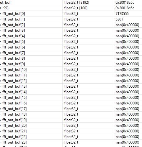

Ok, I might have found the issue. I went back to the tone example above, had it working with an FFT size of 2048. Tried it at 4096 and it worked fine. Tried it at 8192 and got similar issues. I assume it's a RAM limitation and I'll likely need to move to a chip with more RAM than this one.
Is there a way to find out how much RAM is needed for an FFT of a given size?
This is what I'm seeing:
FFT Size RAM Used on Compilation Status
2048 14.39% Working
4096 22.73% Working
8192 39.39% Not Working
If I follow this, I'll need somewhere around 60%+ to be able to run an FFT of size 8192 (about 115.2 kB of RAM, min since the default RAM setup for the WB55 is 192 kB).
I might be able to get a boost if I can configure the full 256 kB of RAM (since it's configured as 192 kB). Regardless, it would be helpful to know how much RAM an FFT takes. Any idea where one might be able to find this information?
Also, any chances there could be another potential limitation (ie the library will only do a max FFT size of 4096)?
My link from above lists limitations, so 8192 seems to be out of bounds.
