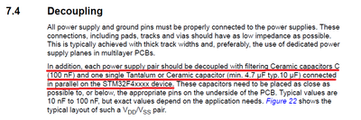

2026-04-06 11:26 PM
2026-04-06 11:40 PM
This is what the AN4488 "Getting started with STM32F4xxxx MCU hardware development" is saying:
No need for that 0.1uF in parallel to 4.7uF.
2026-04-07 12:13 AM
