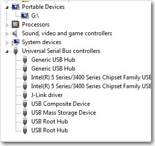

I would appear to have confirmed the connectivity. You should evaluate the SDIO functionality outside the context of the USB MSC.2013-09-09 6:56 AM

Hard for me to judge, I think there's enough material there to work with.
