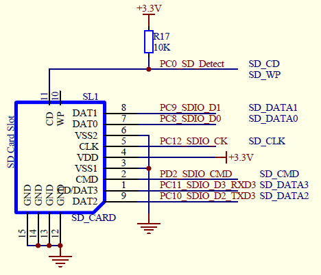

Here's the connection to the card,
Please correct me if I'm wrong STM32 --> SD card PC8 ---> pin7 PC9 ---> pin8 PC10 ---> pin9 PC11 ---> pin5 PD2 ---> pin2 This is the configuration I used /** * @brief Initializes the SD Card and put it into StandBy State (Ready for * data transfer). * @param None * @retval None */ void SD_LowLevel_Init(void) { GPIO_InitTypeDef GPIO_InitStructure; /*!< GPIOC and GPIOD Periph clock enable */ RCC_APB2PeriphClockCmd(RCC_APB2Periph_GPIOC | RCC_APB2Periph_GPIOD | SD_DETECT_GPIO_CLK, ENABLE); /*!< Configure PC.08, PC.09, PC.10, PC.11, PC.12 pin: D0, D1, D2, D3, CLK pin */ GPIO_InitStructure.GPIO_Pin = GPIO_Pin_8 | GPIO_Pin_9 | GPIO_Pin_10 | GPIO_Pin_11 | GPIO_Pin_12; GPIO_InitStructure.GPIO_Speed = GPIO_Speed_50MHz; GPIO_InitStructure.GPIO_Mode = GPIO_Mode_AF_PP; GPIO_Init(GPIOC, &GPIO_InitStructure); /*!< Configure PD.02 CMD line */ GPIO_InitStructure.GPIO_Pin = GPIO_Pin_2; GPIO_Init(GPIOD, &GPIO_InitStructure); /*!< Configure SD_CD pin: SD Card detect pin */ GPIO_InitStructure.GPIO_Pin = SD_DETECT_PIN; GPIO_InitStructure.GPIO_Mode = GPIO_Mode_IPU; GPIO_Init(SD_DETECT_GPIO_PORT, &GPIO_InitStructure); /*!< Enable the SDIO AHB Clock */ RCC_AHBPeriphClockCmd(RCC_AHBPeriph_SDIO, ENABLE); /*!< Enable the DMA2 Clock */ RCC_AHBPeriphClockCmd(RCC_AHBPeriph_DMA2, ENABLE); } it's on SDIO_SD.c2013-09-08 5:13 AM
Where's PC12 go? What about the card detect switch?
This is a schematic of a card configuration, I'd be using pull-ups for all but the clock pins2013-09-08 5:33 AM
Let me correct it :
STM32 --> SD card PC8 ---> pin7 PC9 ---> pin8 PC10 ---> pin9 PC11 ---> pin1 PC12 -->pin5 PD2 ---> pin2 Please correct me if I'm wrong thank youWe’re moving the ST Community to a new platform to give you a better and more reliable community experience.
