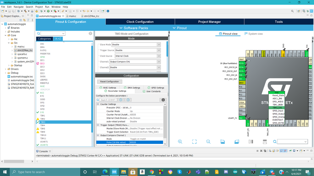

Hello guys , i am supposed to construct a square wave with automatic toggling making use of the output compare channel one setting. the channel one of the timer is in pin PA6 Does anyone know if this is also the pin were the output (final waveform) will be shown? or must i introduce another GPIO pin to connecte it to this PA6 somehow? ANY HELP IS APPRECIATED!!0693W00000BaAZgQAN.png

Yes, the PWM output will be on that pin.
