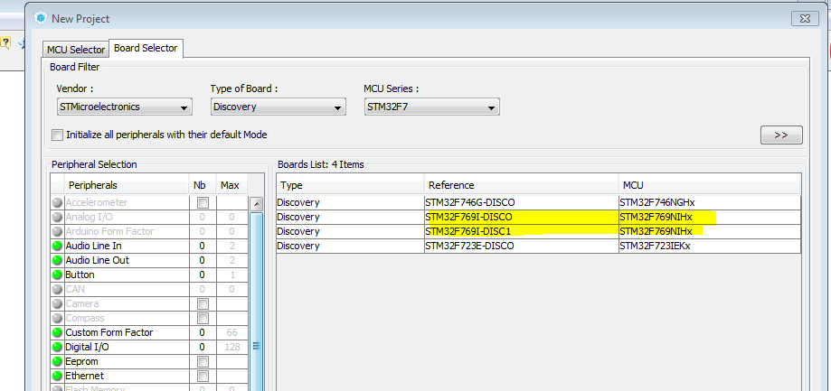

Hello Nesrine,
Thank you for the help. I will use this example to explore QSPI.
I have other question is, can I get CubeMx project for the discovery board: STM32F769i - DISCO (MB1225B).
I want know how the components are configured in STM32CubeMx project. This I will take reference for my development.
Thank you,
