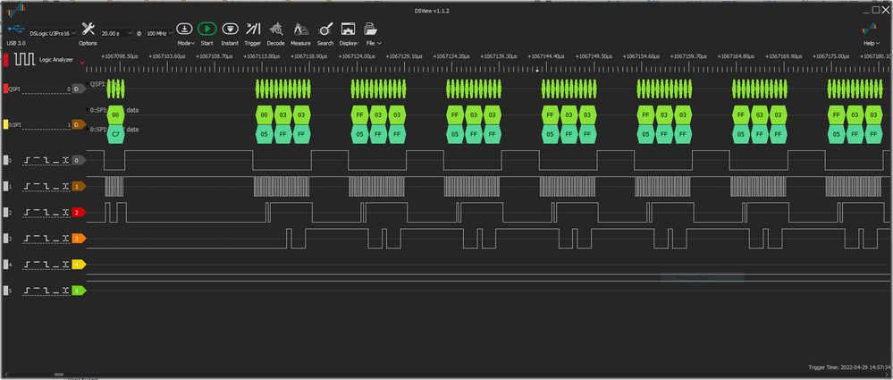

I am trying to autopoll wip and wel bit from status register (0x05) in a flash memory when I perfrom a erase process.
The first autopolling operation is correctly, however, the second time that qspi try to autpoll the bits, this does not release CS, and the data is not readed correctly. I am using HAL_QSPI and inmediatlly after perfrom the aupolling hal line, it finish, but the peripheral continue polling the bits forever.

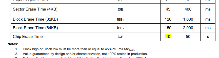

Weird for sure... pretty sure it should work with 1, you'd use 2 for a dual configuration, where you do want both die to complete, and the erase/write are self-timed, so one device is usually done ahead of the other. Full erase of parts can take minutes, definitely hundreds of seconds.

Testing in 1_line (normal spi) mode, the autopolling works perfectly, CS is releasing after each poll.

Yeah, so 60 seconds for a timeout is reasonable here, been working with the 1 and 2 Gb parts with multiple 512Kbit die inside.

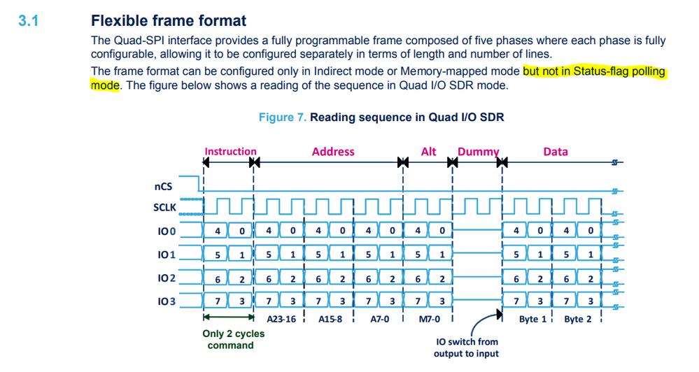

It is not possible custom format frame for quad spi in autopolling mode
